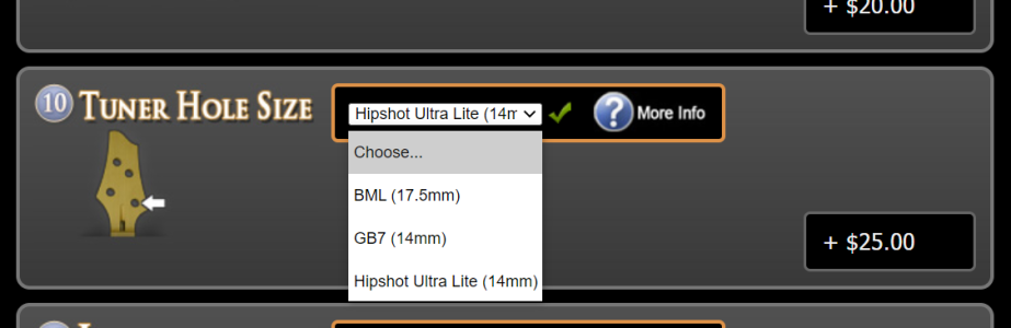

Do you need a smaller or larger hole? If smaller, maybe there's a sleeve insert that can go into the 17mm hole?
Warmoth sells bass tuners that need a 14mm hole so on a build to order neck there are more options than 17mm. See attachment to post which is from the Jazz bass neck builder.

stratamania said:
For Hipshot...
1/2" string post fits 11/16" headstock holes. that is approx 17mm.
https://hipshotproducts.com/products/hb6-1-2-ultralite-bass-tuning-machine
I made the exact same screen capture until I noticed it attached to your post.
Hipshot does make 1/2" (17.5mm) and 3/8" (14mm) USA versions, but they weight exactly the same. They do live up to their name and are roughly half the weight of a normal bass tuner.
