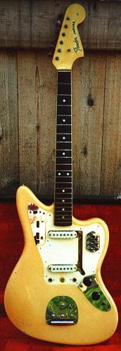

Speaking of blond Fenders, this is an old Olympic White Jazzmaster with the pickguard removed...
That's what happened with old clear nitro finishes, and why some colors were hard to identify due to some pretty severe yellowing.
