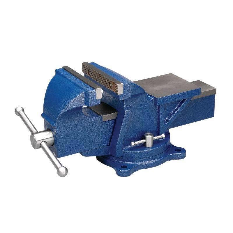

That's a substantial plate. How are you going to bend that thing? You got a press brake laying around someplace?
Also, what are you going to do about hardening? My understanding is that that's difficult to do with stainless.
How badly does it need to be hardened for this application?  Or are you talking specifically about the pivot points, Cagey?
T-304 is already substantially hard, at least the piece i got is. Hard as hell to cut. My little 'ol bandsaw wouldn't even hardly scratch it. Had to score it with a cut off wheel, and work some majic with a hacksaw rest of the way.. :doh:
Don't think I'll have to worry about the pivot points, this steel is tough, I guarantee the pivot bolts will wear out before this plate... :icon_biggrin:
I forgot about the smoke wrench w/ hammer and tongs. That could be made to work.
