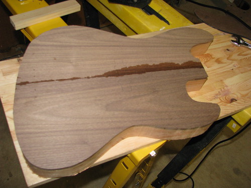

OK, made a LOT of progress on the body blank in the last few days.  I thought they had a Rockler in Greensboro NC, so the wife and I ran over only to find that it had closed.  Bummer.  So on the way home we passed a Woodworkers Supply store and I bought a piece of 10 mil 2'x2' White Oak laminate.  I've been stocking up on clamps like crazy over the past few weeks, so I was all ready to do some gluing.
I laid my body blank on the floor and cut the laminate piece to fit exactly.  Then I slathered (gotta love that word) a bunch of Tightbond II onto the blank and laid the laminate in place.  Then I slathered the laminate with Tightbond and laid the two pieces of Walnut in place.  I tacked a corner down with a finishing nail to help hold it in place while I lined up the second piece.  I squirted some extra glue in the center seam, just to be safe.
Once both were down I applied two large clamps on each end of the walnut to press the two pieces together.  All the rest of the clamps went to holding everything down.  I had gotten a couple pieces of stain-grade pine for top and bottom cauls and a 2x4 ran down the center.  I think I had about as many clamps on it as in the Skuttlefunk example.  Left it to dry for a day.
So today, I opened everything up and it seems to have worked perfectly.  I can't detect any problems in the lamination.  I cut out a Jazz body from the resulting blank and tomorrow I hope to use the Safe-T Planer to reduce the thickness from the back.
Thanks for all the help, guys!  It looks like all the tricky parts are done on this one!  I'll try to get a pic up tomorrow.
EDIT:
Pic 1:
5tvcdy
Pic 2 shows accent line:
JBD

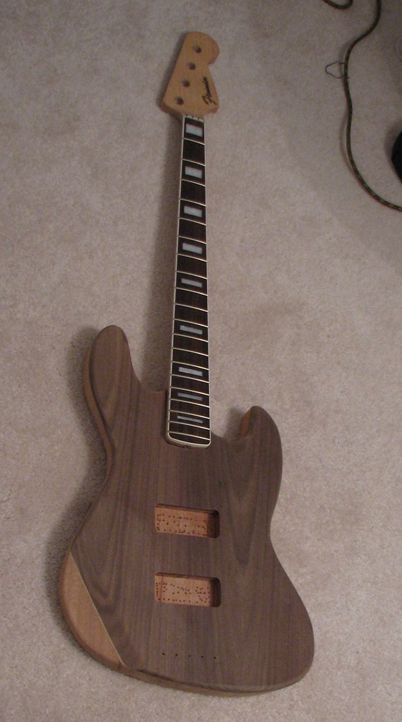

New pics of the bass...  All the major routing and shaping is done.  Still have a couple of things like the truss rod access and controls.
The headstock sez "Flounder"
JBD
