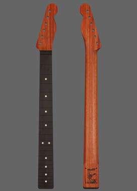

Cagey said:You're going to love that neck. I have one similar - black Ebony over Bloodwood - but it's a Warhead and I fretted it with EVO wire. If I were to rename it commercially, I'd call it "Red Ebony", as it's very similar to black Bbony other than the color. Very dense, heavy, etc. Put it on a candy apple red Strat body, and it's pretty as can be.
Cagey said:Be sure to burnish it - that wood responds well to that treatment and it'll feel sublime - and be aware that its mass/density means the pickups will be more critical than usual. In order to make it "resonate" or color your sound at all you'd have to run it through a rock crusher. So, it means your pickups will return more "honest" results. That's not meant to sound like a negative comment at all - it just means what what the pickup mfr says a unit sounds like is more likely to be real.

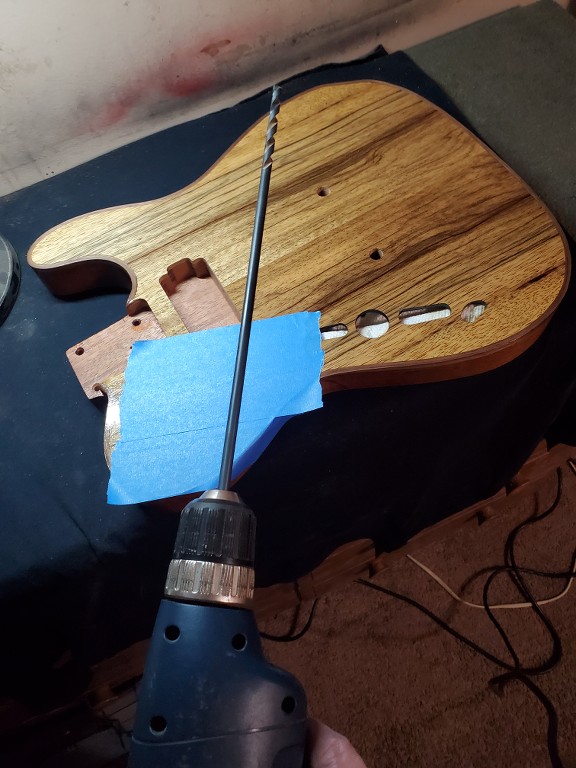

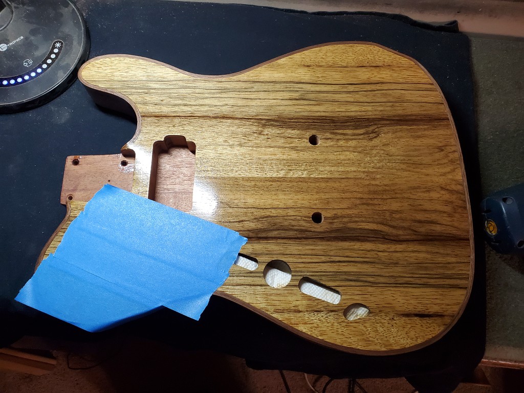

I like to tape a plastic putty knife on where the drill might hit. It'll go through painters tape in a flash but a putty knife just gets a nick.PhilHill said:Alright, it's a little overkill for this. I only have to drill about an inch maybe. Pup wires have to go somewhere, and the cavity seems a likely place. But it'll keep the drill chuck away from the top................I hope... :sad:![]()
Rgand said:I like to tape a plastic putty knife on where the drill might hit. It'll go through painters tape in a flash but a putty knife just gets a nick.PhilHill said:Alright, it's a little overkill for this. I only have to drill about an inch maybe. Pup wires have to go somewhere, and the cavity seems a likely place. But it'll keep the drill chuck away from the top................I hope... :sad:![]()
