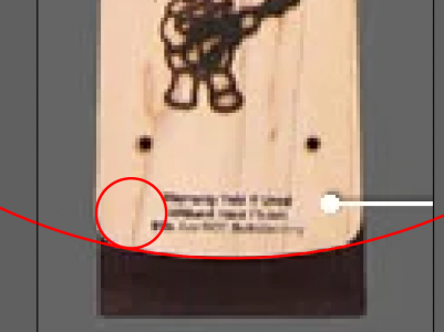

I'm interested in a Warmoth 30" Bass neck for a project and want to know the diameter of the curve of the butt end where it fits in the pocket... and
The radius of the corners of that curve. See attached.

No production run. I just want one dimension from one Warmoth bass neck so I can make accurate drawings for my one-of-a kind build. The idea that I have to buy a part to get the dimensions when every single other aspect is spelled out in detail seems inefficient in the extreme. Plus I'm not to that stage yet. Going to Fender was just an attempt to get some clarity but that failed as well. With so many variables one would expect parts sellers to be specific so buyers can make their choices easier. They seem to want to make it more difficult and customer service is an important factor.

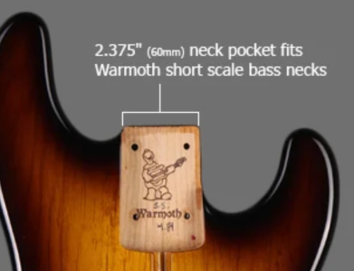

An SSB neck pocket has a published 2.375" 60mm wide neck pocket, and fits standard hardware. In this case, a neck plate to fit a standard four hole pattern.
From that, extrapolate your dimensions. It should get you close enough to decide to buy a neck or explore other options.
Thanks but there is no reason for me to guess when the answer is easy enough to provide.
I can't extrapolate the curve from the width.

I tried matching the curve in Illustrator and it always looks like 10-12 inches which I know is way off. The images are never shot exactly straight on so it distorts the curve. But thanks for the tip.
