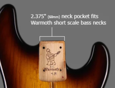

Hi,
When I designed my unique guitar body I also didn't have exact numbers for the neck heel radii or even distance between neck heel and 24th fret.
I only found fender stratocaster drawings were it says 1/4 inch edge radius (so the pocket can be routed with a 1/4" router) and 5 inch neck heel radius.
The rest I "guessed" off pictures from the warmoth page using AutoCAD.
The real dimensions, diameters and such I only knew once measured on the real neck, but the estimated or "guessed" dimensions were easily close enough for the (virtual) drawing board.
In the end I was a bit less than a millimeter off... lengthwise! My first test in MDF for a neck pocket fit was tighter than most manufacturers...
