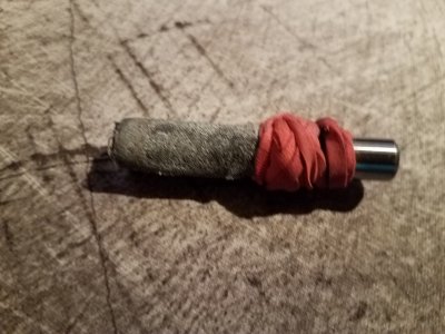

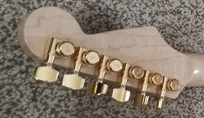

My tuners are having trouble fitting in, I ordered the Schaller locking tuners and the holes drilled out for that size. Is it just the finish on the neck, and what would be the best way to scrape that out if so?
I had the same issue with my recent project. Gloss finish on flame maple. I ended up using sandpaper wrapped around an 8mm dowel pin. Worked amazingly well ...
