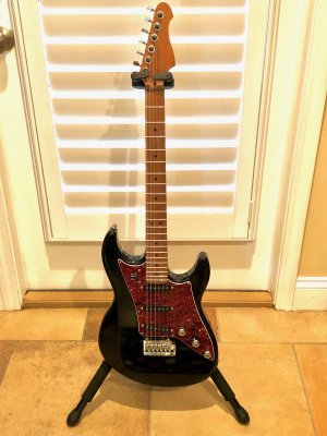

I have a JTV-69S with a Warmoth Fender neck. Details of the neck I bought are below. Note that I put new tuners on as well (Planet Waves auto-trim) so the ream was for those.
The standard mounting holes do not line up. Your best bet is to order without pre-drilled holes (which costs extra by the way) and then drill them yourself.
I shied away from the side truss rod adjust but it might work.
The other mildly annoying thing is that the replacement neck doesn't have a matching contour on the lower heel like the Variax neck. It looks a little odd but does not affect playability for me.
Style: Warhead
Construction: Vintage/Modern Construction
Orientation: Right Handed
Neck Wood: Roasted Maple
Fingerboard Wood: Roasted Maple
Nut Width: 1-11/16"
Back Shape: Standard thin
Fret Size: SS6150 (Stainless)
Tuner Ream: Schaller (25/64")
Radius: 10-16" Compound
Scale: 25-1/2"
Fret #: 22
Mounting Holes: No Mounting Holes
Pre-Cut Installed String Nut: GraphTech Black TUSQ XL - Standard Nut
Inlays: Black Face Dots
Side Dots: Black Side Dots
Finish: No Finish
