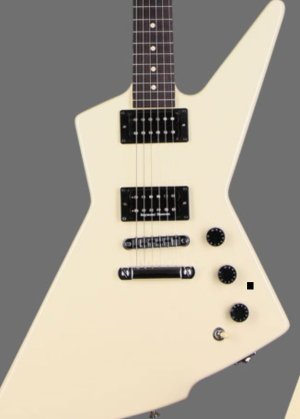

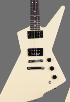

I have a Warmoth Nomad body, and when finished, the controls will be placed just like the enclosed picture.  Where would you suggest that I drill to add a toggle switch to flip the phase?  This is a difficult problem, and any advice is welcome.  :headbanging:

Not sure there are any 'good' places to put a switch, from an accessible vs obstructive pov. I'd just place it in line with the other controls one way or another. I mocked up some possibilities - in my order of preference, left to right:
I suspect that there may not be room for the first and last options.
I'd put it there
or opposite on the upper side but the same distance from the 2 rear most knobs, or maybe inline with the 3 way switch
... but note that this is just a quick dab to mark the location ... it would be a round hole and one of these mini toggles
with a flat(ish) black handle
http://www.ebay.com/sch/i.html?_from=R40&_trksid=p2060353.m570.l1313.TR0.TRC0.H0.XDPDT+switch+black.TRS0&_nkw=DPDT+switch+black&_sacat=0

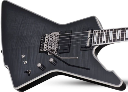

I still think I'll merge the two EMG devices together, but I noticed the enclosed design and thought that it looked pretty clean.  Two toggle switches (in my case) would be for phase, and for on/off.
