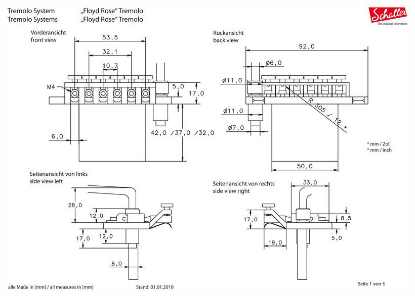

I was just looking a Schaller's diagrams, and on all the Floyd Roses, both as far as I can tell the Original, and the actual Schaller Floyd Rose all have a radius of 12 inches at the bridge,
the locking nuts seem to have an 10 inch radius
but the Warmoth Web site says 10" for both http://www.warmoth.com/Genuine-Floyd-Rosereg-Original-Tremolo-Gold-P546C693.aspx
I know it's only a bit different, and easily within wiggle differences, but which is correct?
If you are going to use a Floyd with a Warmoth compound 10" - 16" radius you need about an 18" radius at the bridge. To achieve that it's done with shims.
Well, this is it, I'd prefer a more cambered straight 10" fretboard, its just I don't want to pay extra for something that would make it less suitable than the compound radius.  :icon_scratch:

To shim it for the Warmoth compound radius is explained in this video.
[youtube]7naBd2cuIcU[/youtube]
Shims can be bought from various places for the job.
