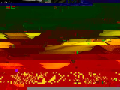

This is how I did it on a mockingbird. It balances great. It's also very close to the SG factory spot so it should work for you.

I like willyk's spot, genious

Willyk,  ive considered doing that to a build i made which has very little horns. But does the Strap pin get in the way at all?

If you mean does your thumb catch on it when you're fretting high, no it doesn't impede "MY" progress. That's not to say you would find it comfortable, I don't know how you play. Unless you play a lot with your thumb braced on the neck heel you should find this spot ideal. The guitar balances beautifully, much nicer than a gibson SG position. Try taping a cork or something in that spot and see if it annoys you before committing yourself and reaching for the drill....all the best mate!  Willy

Yeah--I found it strange that I could not find this topic on the board already--unless I just didn't search well. Judging from the Mockingbird pic, I'm sure you would run into this issue on several body shapes. I had thought about on the butt of the heel joint like that but I would probably get a contoured heel as well, so that would be another factor.
