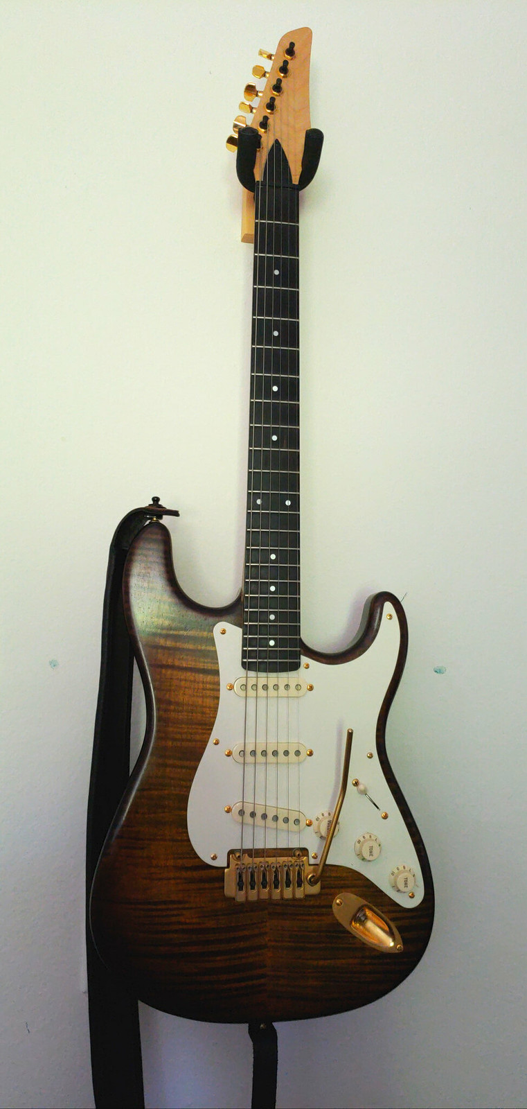

Here is 2 coats of rattle-can Zinsser shellac over dye'd curly maple, topped with six or so coats of Tru-oil applied with a coffee-filter.  I ended up with sort of a matte finish because, frankly, I couldn't be bothered to keep applying Tru-oil and then rubbing it out, but I really like it.
Absolutely beautiful bagman.  Thats the finish feel i was thinking of.  Also was thinking of doing one with a gloss like finish at the end.  Would shellac with a final poly finish over it be ok.  I prefer the matte look most of all but would like to protect it as well.
Agreed; that's a TRULY BEAUTIFUL Guitar, Bagman! Nice Work!  :yourock:
