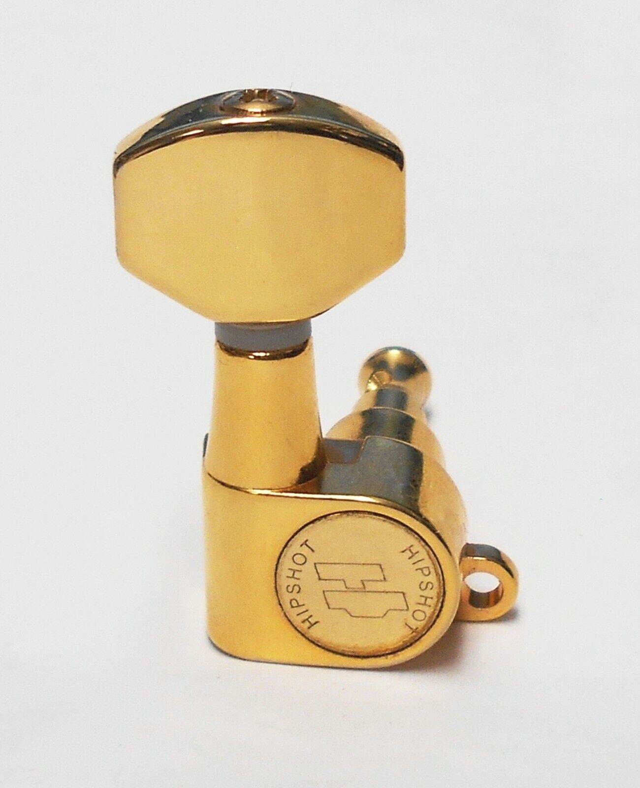

The Hipshots are this model. They're VERY light, which is great for a 12-string. Half of them will have the buttons replaced with tortoise.
