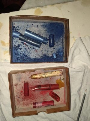

Applying the same idea to sinking pigments into the grain of some figured maple with Tung.
The trial piece is a few different makeup colors in different orders. The blue is the same artist pastels, the rose color is NARS blush in their well known Orgasm color. I think that's what I'll be using for at least part of the next guitar, have to do more steps to get a better feel how to execute.

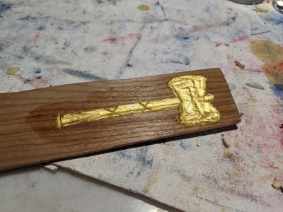

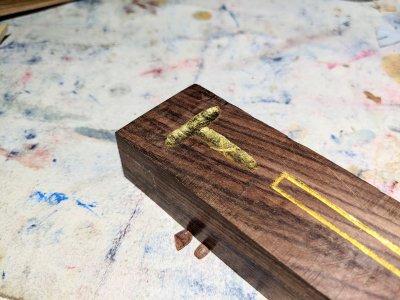

First photo is of a failed and then repaired attempt. Teach me to read carefully, the leaf I could get at our local art shop turned out to be
(golden) copper / brass, about 5x thicker than the real thing, so my first attempts went poorly.
I ordered the real thing and the second two images are done in rosewood (so similar to the real thing when I do the guitar face).
Narrow grooves are a lot harder to leaf correctly, so I'll probably make the final go with shallow rounded cuts.
Quite pleased with how this is going, I intend the fully finished axe to be competitive in the next owner-done GOM :).
