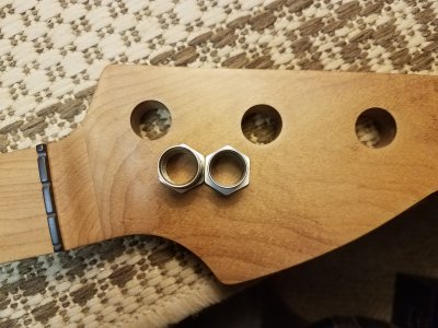

3/20 update: just a pic of the new and old bushing.

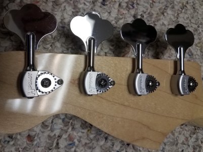

I had a problem installing the first one. It stripped the first couple of threads when I went to tighten it down. It seems it barely is able to reach the threads to grab. The next three went ok. I believe the issue is the shoulder on the new bushing is thicker and the reach is not as long. I also believe the head stock width on Warmoth neck is a little on the thicker side compared to average size. I just used the original bushing setup on the stripped one and it seems to be fine. They all lined up well and I didn't sense any movement when I set the bass up It should be good to go. I think in the future I may stay away from the hipshots. They don't seem to be an easy install with the Warmth necks. Hay at least I didn't screw it up.  :turtle:
