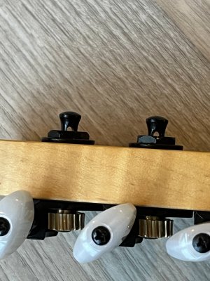

Got my tuners today. Hipshot staggered open gear classic (non-locking).
I got these to avoid neck dive since the body is super light.
Installing them using the universal mounting plate was easy, but i discovered that the string hole is note clearing the top of the nut and washer completely on the high e and b strings.
I haven't tried stringing it yet, but i fear i won't be able to get enough winds on this.
Have any of you had this problem with these tuners?
The neck is a Warmoth gibson conversion tele neck. I discovered that the head is slightly thicker than the head on my Fender Telecaster. This might be part of the problem.
Are those the E&B tuners? You might get away with that, but if not - I would try using a much thinner washer (and torquing down hard).
You only need a wind and a half, with a good 'lock stringing' technique...

Yes, it's the E and B tuners.
I usually prefer 3 winds on the thinner strings to avoid slipping. I'll have to see how many winds i can get on there when i get a bit further in the build.

Perhaps without the UMP plate they will protrude a little more.
Another option would be to see if you can get those two machines exchanged for the next longer length.
I agree, it's probably the plate making the difference. I never use those, I prefer the cleaner look without. Just line them up good and drill holes for the screws. Unless you're just trying to cover up old screw holes......
Removing the UMP might help a bit, but the plate is only 0.5 mm thick. It might be enough, but i'm not sure.
I need to get some sandpaper to widen the holes for the string ferrules a bit, and once i have those installed I can try stringing it up to see how many winds i can get on the post at the moment.
I'm going to take the guitar to my luthier at some point anyway to level the frets and do most of the electronics, so i'm concidering having him drill the holes for the tuners as well. I could try it myself, but I'm a bit afraid to mess something up..
I see Hipshot sells single tuners in all lenghts, so I'm concidering ordering two tuners in the medium lenght like Stratamania suggests if removing the plate doesn't help.

Does the string slide through? If so, you may want the tuner protruding less, as this will give the string a slightly lower break angle over the nut. On the Warmoth Tele I built (avatar), I used the Hipshot Locking tuners. The E and B string holes fully protruded, but on the E string I was getting a little buzz. I added a string tree and it eliminated the buzz. There wasn't enough of a break angle. On another build, I used the same tuners and there was no issue.
IMG_1657.jpegDoes the string slide through? If so, you may want the tuner protruding less, as this will give the string a slightly lower break angle over the nut. On the Warmoth Tele I built (avatar), I used the Hipshot Locking tuners. The E and B string holes fully protruded, but on the E string I was getting a little buzz. I added a string tree and it eliminated the buzz. There wasn't enough of a break angle. On another build, I used the same tuners and there was no issue.
Yes, the strings does come trough, but there’s just enough room to get enough windings on there.
After three windings, the string is beginning to overlap on the b string.

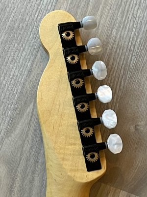

I have handed the guitar over to my luthier to have the frets levelled today, and I asked him to drill holes for the tuners as well. I’m hoping removing the mounting plate will give me enough space.
This is how it ended up after stringing the guitar up:
