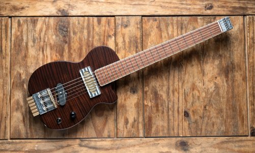

My main electric is a super tiny headless, an Island Instruments Espeto:
What I love about that instrument is its super compact size and light weight, small single cut body shape (patterned after the Harmony H44), and the very short scale length (Byrdland scale to be exact, 23.5"). It has a pine body, dramatic flamed maple top, oak neck, and mesquite fretboard (which has darkened considerably since I got it). It's loaded with Mojo Pickups UK electronics.

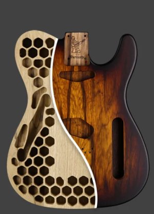

So, for a complimentary Warmoth build, I'm considering one of the 7/8ths sized bodies and pairing them with one of the 24" scale necks to get close to my preferred small body/short scale length thing. The 7/8 T-style body is easily my first choice, but I've read some people say it ends up being neck heavy/dive-y (with the 7/8 warhead neck, mind you) compared to the 7/8 S-style body. I think a stouter body wood choice could help this, but I am looking to get it chambered and go for a jazzy Tele sort of thing and load it with some Seth Lovers.

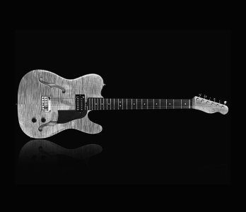

I got the idea for this instrument from Stefan Schottmueller's Television guitar model:
If I wanted to go full jazzy and only keep a neck pickup, is there any workaround for the index hole fill situation? Like, if I were to order the body chambered with a laminate top, must the laminate top get the index hole too (from a Warmoth production perspective)? I'm interested in pairing a spruce top with the chambered body to get nice and resonant, acoustical. I know Warmoth can fill the index hole with the same top wood but I'm always bothered by the despite their best efforts, obvious grain mismatch. I'd love to be able to avoid it, but it seems like the only solution is to get a bridge pickup and be done with it...

However: Chambered is not hollow! As far as I understand, the chambering Warmoth offers was developed to reduce the most weight with the least sonic difference, which might be something different than you expect.

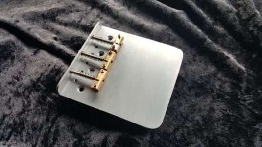

If it’s a Tele - maybe something like this?
https://www.etsy.com/listing/1669326009/bridge-for-telecaster-style-guitars
If you don’t like the cut of that particular jib I’m sure Armadillo or Rutters could make a six saddle jobby
These are cool bridges, I saw a similar configuration a few months back:
I guess I'm more interested in the T-style body for its shape and ergonomics and am less after the Tele tone (I've already got 2 guitars with 3-saddle brass bridges), but a big blank ashtray bridge would solve the index hole issue.
