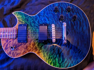

Body:
Model: Chambered Carved Top Regal
Orientation: Right handed
Scale: 25-1/2"
Wood: Flame Maple / Maple on Mahogany
Rout: Rear Rout
Bridge: TOM/STP, Angled Pocket
Jack Rout: 7/8" (22mm) Side Jack Hole
Neck Pocket: Strat® Shape
Contours: Contoured Heel
Binding: Ivoroid Binding
Top Finish: Tropicana Tilt Fade
Back Finish: Clear
Finish Type: Gloss Finish

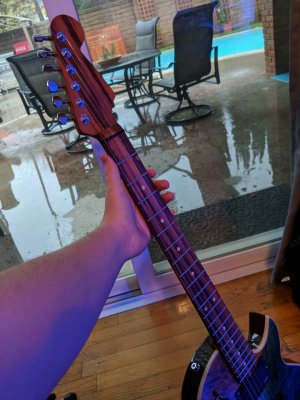

Neck:
Style: Stratocaster
Construction: Modern Construction
Orientation: Right Handed
Neck Wood: Quartersawn Goncalo Alves
Fingerboard Wood: Goncalo Alves
Nut Width: 1-11/16"
Back Shape: 59 Roundback
Fret Size: 6150
Tuner Ream: Gotoh/Grover (13/32" 11/32")
Radius: Compound
Scale: 25-1/2"
Fret #: 22
Pre-Cut Installed String Nut: GraphTech Black TUSQ XL - Standard Nut
Inlays: Cream Face Dots
Side Dots: White Side Dots
Finish: None
Hardware:
Neck Pickup: EMG 81
Bridge Pickup: EMG 85
Bridge: Gotoh Tune O Matic Bridge, Chrome
Stop Piece: Gotoh Stop Tail Piece, Chrome
Tuners: Gotoh Magnum Lock Traditional 6-In-Line
