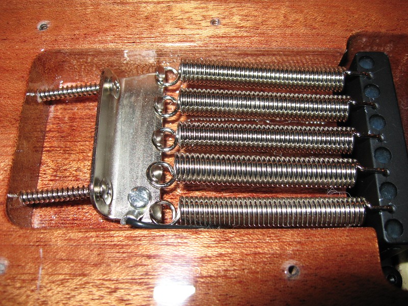

These little clips work. No soldering necessary.
I just slipped it over the screw and then squeezed it tight with needle nose pliers.
I use a Sta-Kon terminal as well, but drill/tap a hole in the claw to attach it so it's nice and tight...
Crimp the lug on, solder it for good measure, and run a 6-32 machine screw in. That baby's grounded.

Or, drill the hole. That's not tough, either. But, you do have to tap it or use a nut/bolt combo to get it to work. Seems like I've even used self-tapping screws more than once, which makes it even easier.
