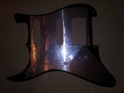

The spring claw is grounded which is grounding the bridge. This is necessry.  With a pickguard, grounding the cavity serves the purpose of preventing static electricity between the paint in the cavity and the back of the pickguard from causing "pops" and noise. I actually cover the back of the pickguard with conductive aluminum tape for this purpose. It's for static. It does nothing to reduce hum from single coil pickups, transformers, or flourescent or neon lighting...
