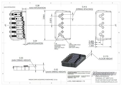

I still have do do some micro measuring before committing to either the .125 or .175 but I am 'suspecting' I'd not be able to get a high enough action with the .125.
UPDATE: I measured my old 1980s hard-tail Warmoth and even the .175 won't give me a high enough action -
and I even have it set pretty low right now.
My (Unknown brand name) Bridge mesurements
Floor Height = ~.086 to ~.089
Low E from the body ~.570 Top of String - Bottom of String ~.534
Hi E from the body ~.543 Top of String - Bottom of String ~.533
Measurements of the string from the body were done as close to the saddle as possible.
Attached see the specs for the .175 model.
