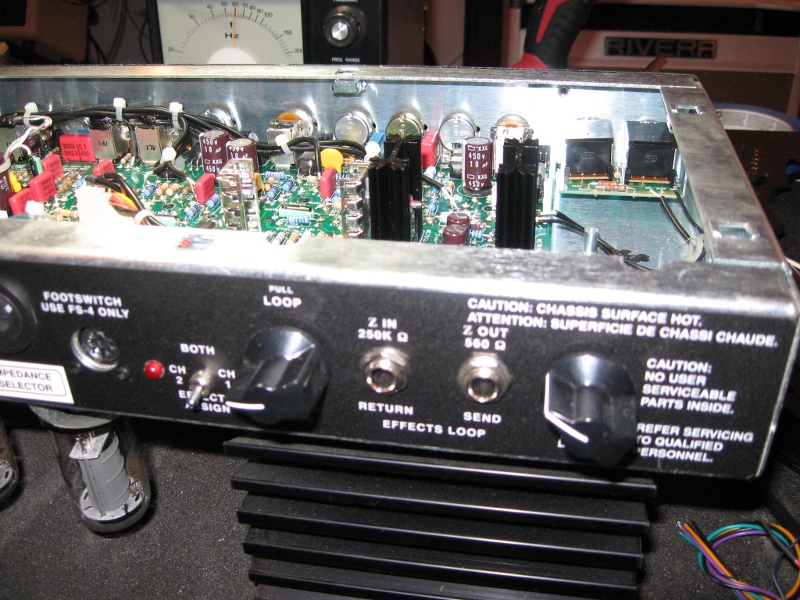

Not all effects loops are created equal. For instance, I have a Rivera Venus 6 on the bench right now that has one of the better loops I've seen...
It has level adjusts for both the send and return, plus a switch to set whether the loop is in the first, second, or both channels. You'll also notice they've marked the impedance ratings of the in/out, which is unusual but handy to know. Pedals designed for the front end sometimes won't work as well in the loop due to impedance mismatches. Sounds like that may be the problem you're having.
I'll have to get a pic of the back of my amp.  The Send/Return on mine also have knobs, which I have turned up about halfway for each.
