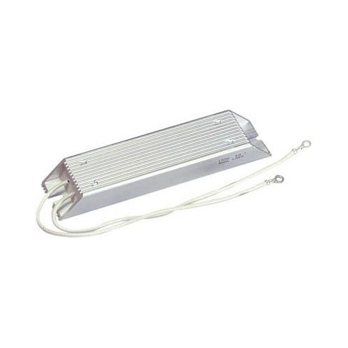

What do you mean by "beware of running the pre-section without a load on the power section of a tube amp?"
It means run the amp into a speaker or a dummy load so you don't reproduce the same problem that got this amp trashed in the first place.
bagman
Incidentally, I happen to be working on a Rivera Venus 6 amp at the moment and needed a load, so I bought a dummy from Parts Express that looks like this...
Nice little part. 8 ohms, 100 watts, well-built - you could use that on just about any amp. Solder a 1/4" phone plug to the leads and you're good to go.
Parts Express' website leaves something to be desired, but you can buy the part at the same price via Amazon and Parts Express fulfils the order.

Simple enough, and YES, I have a speaker hooked up to the head, unlike my dumbass friend did...
