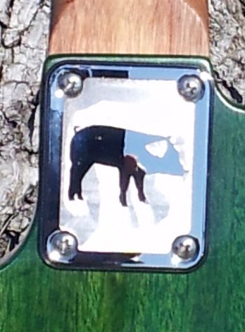

Bagman67 said:
...and a bitchen neckplate by DangerousR6, DUH!
Hah. That neckplate reminds me. In our area there's a farm, family name Bacon. They have a sign by the road, "Bacon Farm est.1825'  On the sign is a picture of a cow. Every time I see it I think... you've been farming for almost 200 years and you still don't know where bacon comes from?
Sweet build, I don't recall seeing this one.
Thanks, man.  It's looking pretty chewed up nowadays - it's the one I leave out so I can always grab a guitar.  My toddler has literally taken after it with a wooden hammer, and the finish was kinda dodgy to begin with, it being my first complete job.  Now it's looking extremely, er, well loved.  Which it is - my favorite axe to play, no doubt.

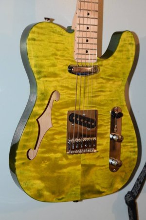

Very nice. I recently built my son a thinline tele with green alder back, and "swamp-gas" face (lemon yellow with green mist around edges on flamed maple) so I had to look and see how your green turned out on mahogany. Liking the nice clean route around the P-90's.
