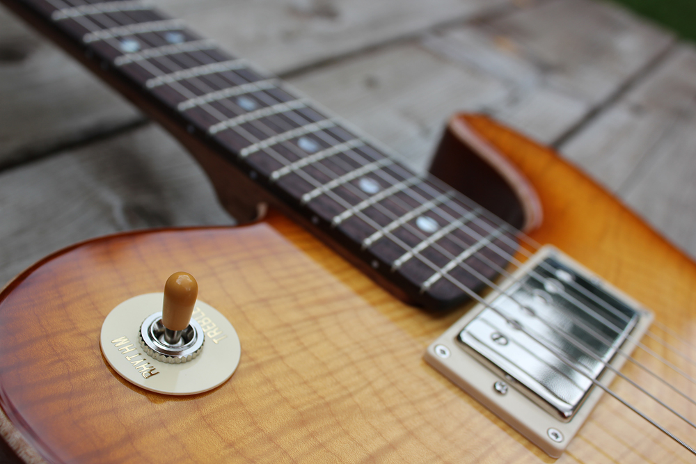

Is the body a Warmoth finish or your own?  Is the neck unfinished/burnished?  Details, please!  :glasses9:
Both the body and neck finish was done by Warmoth. Honey burst body, and clear satin nitro on the neck. After I applied the ink transfer logo, I brought it to GTA Guitar Repairs here in Toronto, and had the headstock shot with a nitro finish.
My ONLY complaint about the guitar is that the fret edges on the high E side were filed a little too much inward, causing the string to slip off the board if I get too aggressive when playing. But I think moving the string over via the saddle and nut slot will be an easy fix for this.
Full specs!

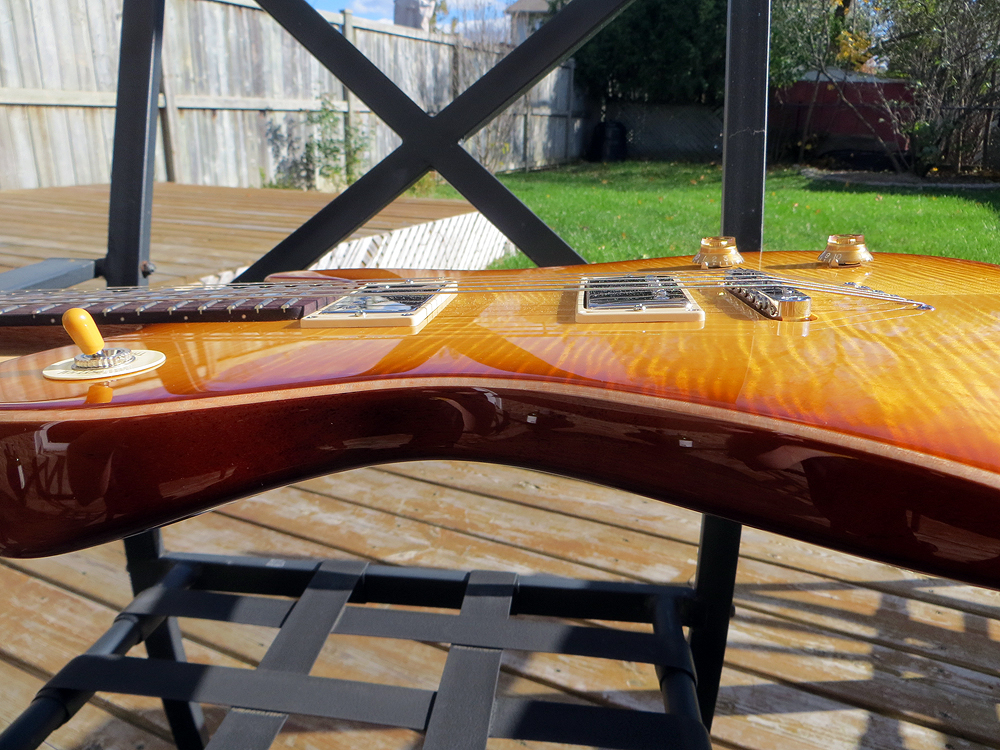

A little update :
The neck was sitting pretty high in the pocket (see first pic below). This was causing the bridge to be set pretty high as well. The steep break angle of the strings over the bridge to the body was causing the guitar to play fairly "stiff". I had the pocket deepened to essentially create a "720 Mod". The compliance is much more elastic when bending now and the guitar feels really great after this mod :
Before
After
