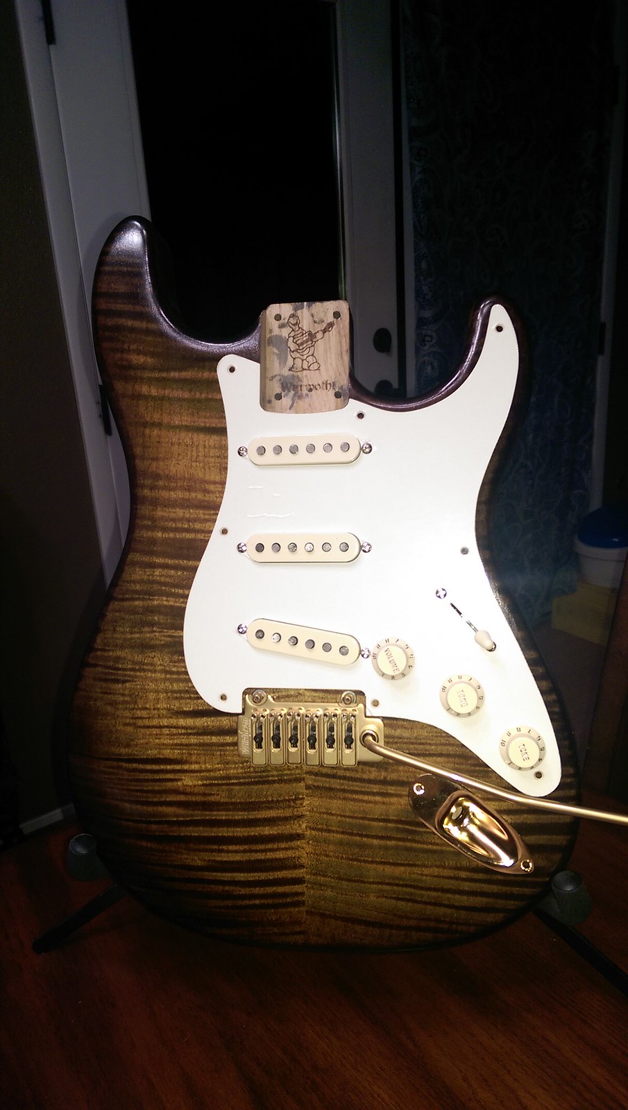

I don't know about you, but I'm finding it tough to settle on a pickguard for a tobacco burst. I have one here just rotting waiting for me to finish it off, and as close as I've gotten is a plain cream 'guard. It's weird. It's like nothing works with it.
Single-ply parchment FTW (IMHO):
Sure, it ain't technically a traditional tobacco burst.  But close enough for me.
I agree; that's probably as good as it gets. And at least on that one, it's pretty good. Nice piece.
