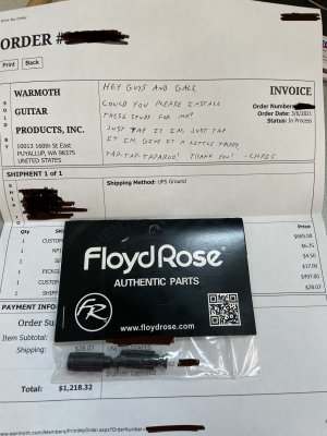

I called to see if I still had time with my build to mail them my studs to install, since I don't own a drill press (yes I know you don't 'have' to use a drill press to install them, but that's one of the more safe ways to be sure they go in straight and true), and since my body is in paint...the guy (not Spike, it was someone else) said, "Paint takes WEEKS...yeah, you have time."  So I mailed them. That's one less thing I have to worry about when I receive that gorgeous hunka swamp ash and flame maple.
Not my original ones though....heck no...occasionally, I know it's difficult to imagine...but occasionally, all the major carriers (yes, even FedEx...even UPS...even USPS...even....all of them) lose a package.  The ones that came with the Floyd unit are still sealed in their original packaging.  I bought two more, and shipped those.  They received them today.  I left them a note.  I hope they got the reference.  If not they'll think I'm weird.  :icon_jokercolor:
