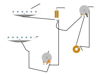

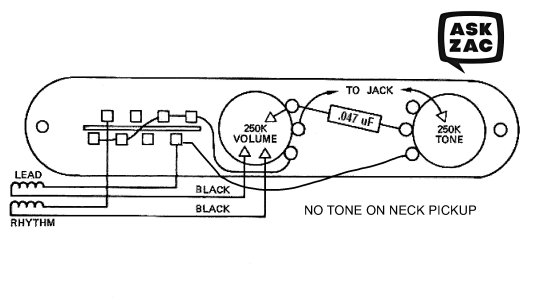

I want to set up my guitar so that I can have the neck and bridge pickups eq'd differently, without a bunch of knobs. I have been looking at stereo. But I realized this might be simpler. What if I disconected the tone from the neck pickup, then eq'ed the amp for that pickup. When I switch to the bridge pickup the tone pot works there so I have two pickups that both sound great.
The problem is I can't seem to figure out how to disconect the tone from the neck on a 1v1t 3 -way toggle 2 pickup circuit. Is this possible?
Any help appreciated.
