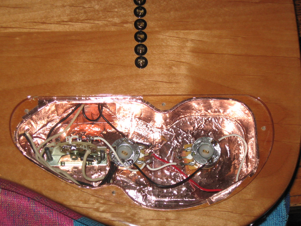

Here is my first try at wiring up a guitar.
Overall, I'm very happy the way it came out.  Sure does help having a nice iron to do the work with.
Bill

The only problem I see with this Tele is .... I don't own it... ha ha ha
Nice Job!!
Bill
Hey Bill, what kind of pots are those? :icon_scratch: I've never seen any like that....
