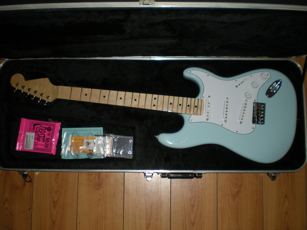

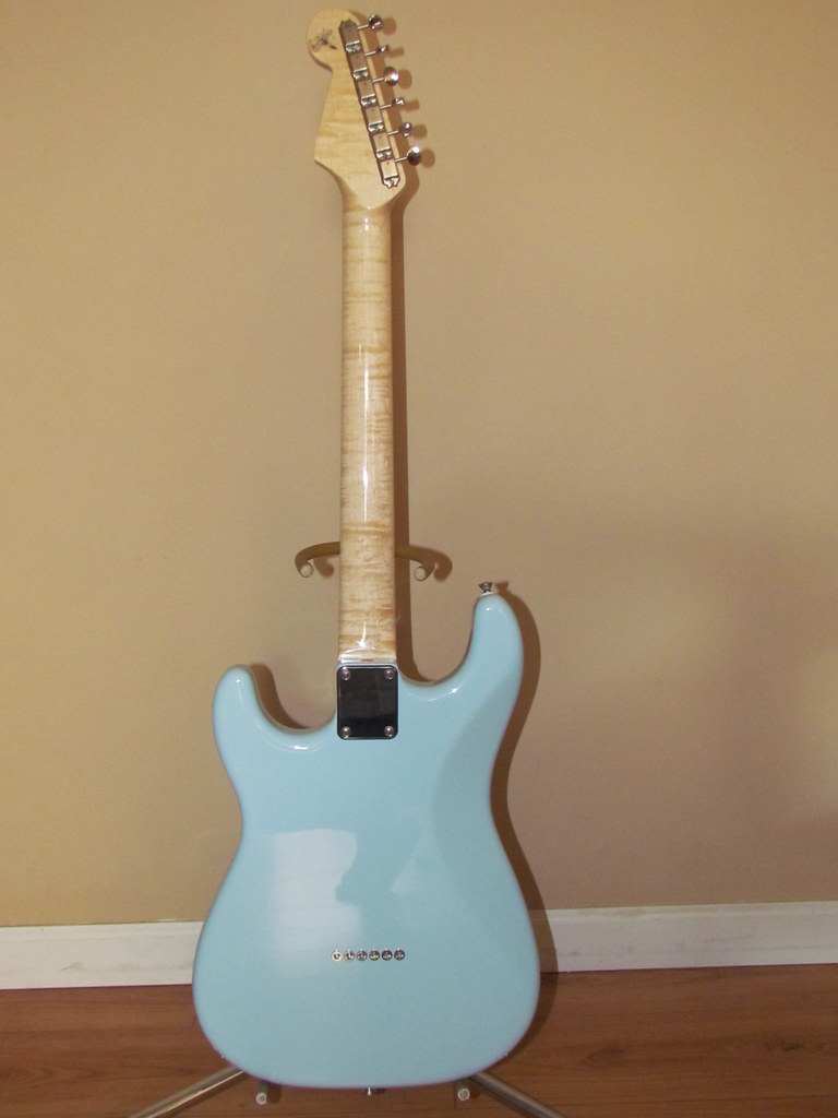

It's Done!
I got the guitar back from the Luthier on Tuesday July 31 (7/31/2012) exactly 2 weeks after I had dropped it off.  He had it sitting on a guitar stand in his teaching room and it was plugged in and ready to go.  I played it and was blown away by it's playability and powerful sound!
Anyway, when I got it home, I applied the logo decal (it's a sticker, not a water-transfer decal):
I put the Turtle on the back of the headstock:
Here is the front:
Here is the back:
I will make a YouTube video of me playing it and maybe some MP3s of it to post to SoundCloud.
