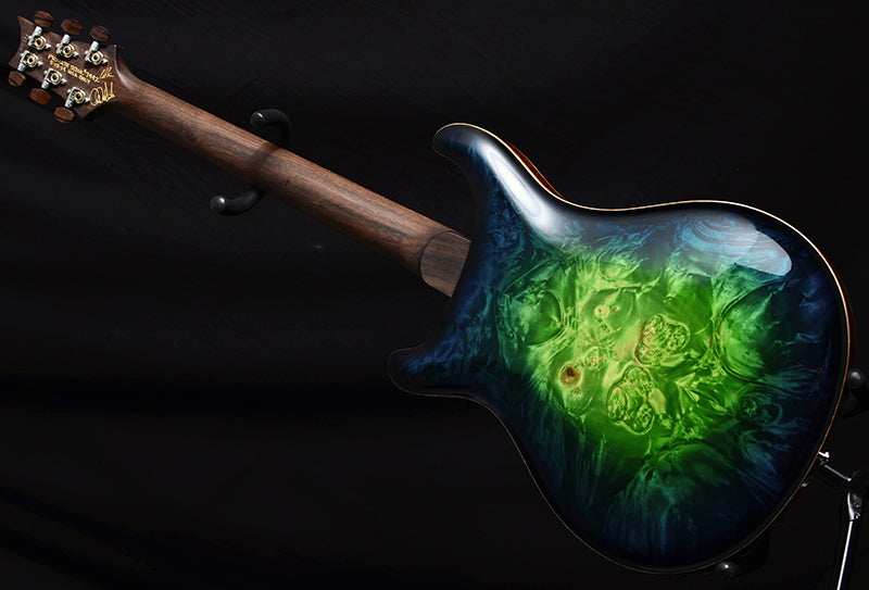

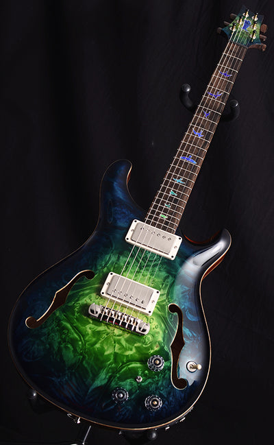

That is turning out gorgeous. Makes me reevaluate my feelings on burl tops.
Funny thing is I never liked burl tops either until I saw that PRS with the satin finish, unfilled holes, and black dye glow.
I still don't like burl tops with natural finishes, but with dyes I think they look great.
Here's another one that looked quite spectacular:
