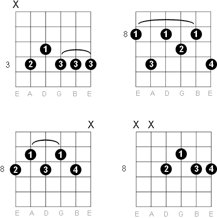

C#9 ....
is that C sharp 9
or C9?
if it's like this (bottom left) , there's absolutely no way I'd play that with my thumb. That's nutty to me.

GoDrex said:
C#9 ....
is that C sharp 9
or C9?
That's C sharp 9
Sharp is shortened #
Flat is shortened b (Cb9)
Check out John Mayer playing Everyday I have the Blues. The main riff is played on a C9. His hands are huge!!!
tfarny
Senior member
4,481
It's a movable ninth chord with the root on the A string. Very good chord to know, it's a QD version of the 'hendrix chord'
