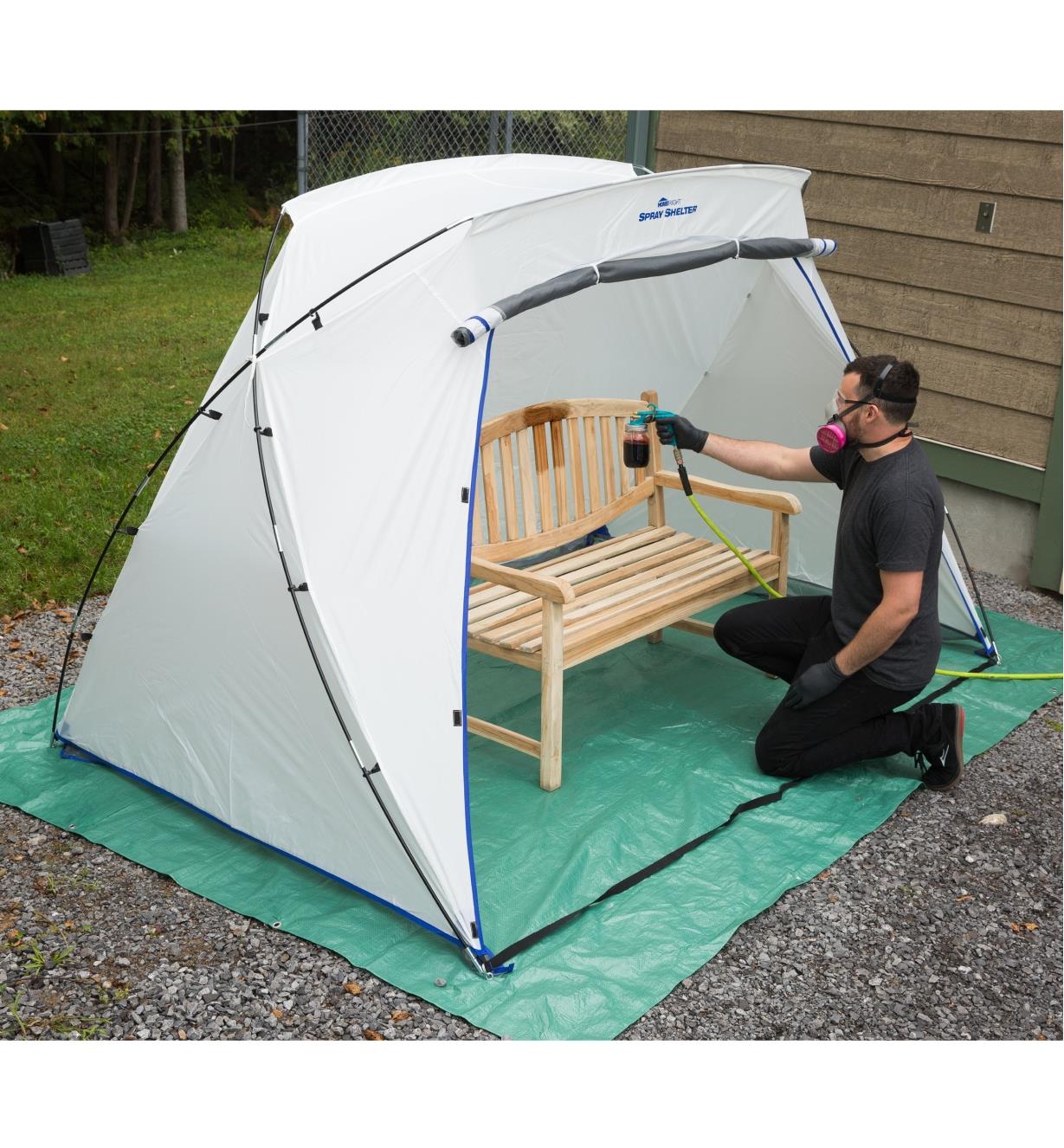

Get a cheap-ass paint booth thing.  Like this one:
They make smaller ones as well.
Thanks....I didn't even know there was such thing. I'll have to remember that for home projects. For this video I am actually using an old retired paint booth we've had sitting around for years.
It's not in the sanitized, dust-controlled environment that is our paint department. It's just sitting in some warehouse space, so I'll still be dealing with dust and stuff.

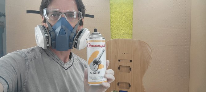

Second can of sealer today.
Reminds me of a Fender custom shop Mary Kay finish Strat I used to have, only nicer!
Well, kind of late for my suggestion. I would use finishes all from the same source to minimize incompatibility issues.

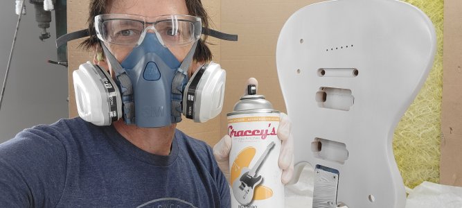

Olympic White undercoat today. So far so good!

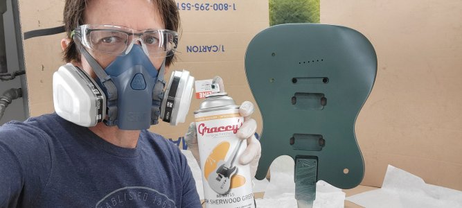

Color coats start today.
I am not sure, but I think you look better in the protective garb. You may have just found a new look!
Why does everyone keep telling me that?
Spray booth made out cardboard, that's great!  Remember to smile!  :toothy12:
