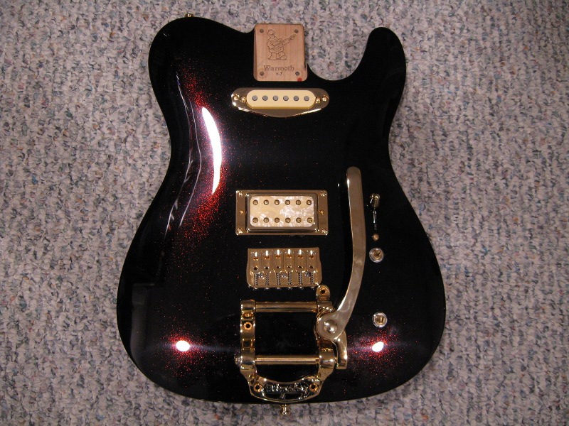

Cagey, that's one nice looking loaded body you have there.  Sustainerplayer and Altar, I agree with you.  I'm not a big fan of the white Fender in the links but with some tweeking and imagination (like the LP/Gretsch style pickgard, rear route upper horn toggle) that might start looking good.  Funny thing was that I was thinking of white as a tribute to the White Falcon.....  Too bad Warmoth doesn't offer gold bindings!!!
