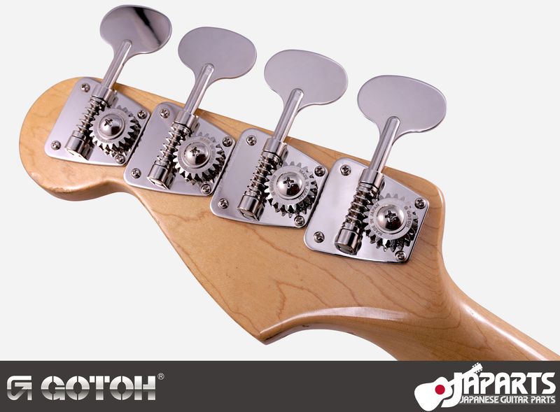

I've decided to go for these tuners:

Right Lollipop tuners bought and fitted, not 100% straight, but I never seem to quite get it quite right.. c.f. the fretless T-bass ones, always just a tinsy-winsy bit off. Anyway.. Here's the circuit diagrams I'll try and blend together to get the switching configs I want..

Gotoh tuners with the lollipops fitted! A bit heavy, but that's what you get for going for the retro look and being too much of a tightwad to get the low weight ones. (Just as an aside I put some Gotoh lightweights on the fretless Custom T bass and there's a whopping great deadspot on the 9th fret semitone on the G string)
