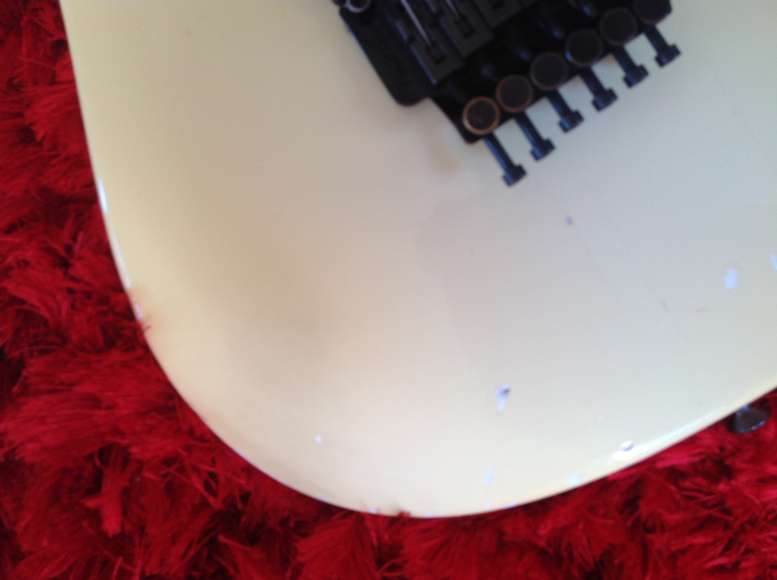

So I am guessing the Tele, had the angled pocket...how its sitting is looking is similar to one of my guitars from the 80s that is a set neck with a slight neck angle and a Floyd that is not recessed.

Yes it works great. Still, it is in an exceptionally well made late eighties Hamer Chapparal Custom.  This was my main guitar for years. A couple of years back the original worn frets were replaced with Stainless Steel, a dodgy tone pot replaced and a more up to date Floyd arm, which is easier to adjust although there was nothing wrong with the original.
Here are a couple of photos of the "stratamania's old number 1"
Hamer3 by stratamania, on Flickr
Hamer4 by stratamania, on Flickr
