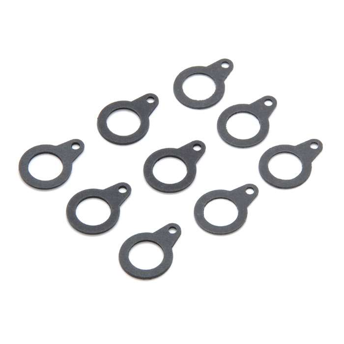

Another option would be Kluson stagger set. These will take any non staggered tuner and convert them to staggered
