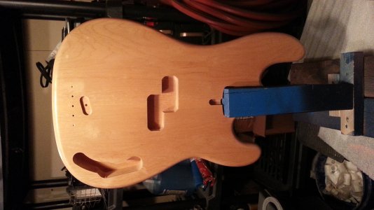

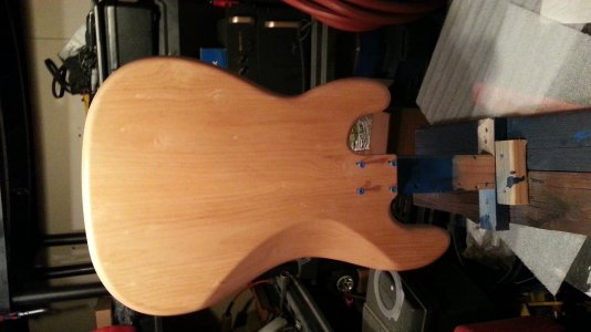

So, did the sanding sealer, then did 5 coats of grain filler. Tomorrow after it cures I'll probably hit it with some 800 grit and give it a light sanding. I'll probably put the neck on it temporarily to see how it looks. Then I'll decided if I'm going to paint it or not before I put the clear coat on it.
The neck is a maple fret neck, so just leaving it all 'plain' might look fine. I'll let it sit around a day or three with the neck on it while I decide.

800 grit is almost certainly too fine. 320-400 is more like it, and that's pushing it. Most finishing schedules would have you use 220. 800 will cause you a great deal of work as it cuts slowly, and it'll leave too fine a surface for additional finish. You'll run the risk of the fresh finish material not having anything to "bite" into, so it won't adhere as well as it should. Any later blemish will result in large areas peeling off.

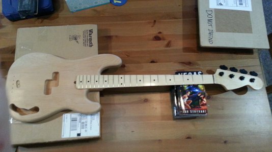

Okay, during lunch I went out and lightly sanded the body (320 grit, think that's good enough or should I hit it with 220?) Then stuck the neck on it. Still trying to decide if paint, or just clear coat.
Here's two pictures of it currently:

Coming along... What color are you thinking if you paint? If you got grain a clear coat is certainly tempting.

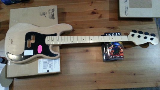

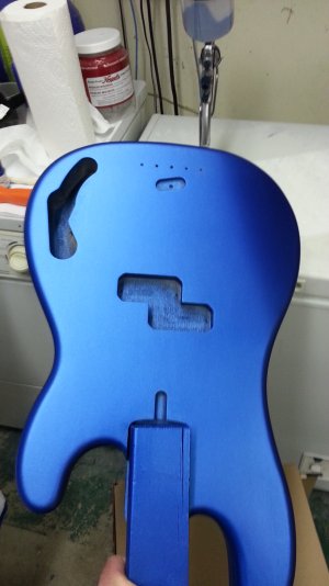

Okay, here it is after painting. The cellphone camera doesn't capture the pearlesence effect very well, but it really looks nice. Probably will give it a couple of days to fully cure before I clearcoat it.
That blue looks great. Nice choice on that color.  :icon_thumright:

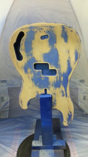

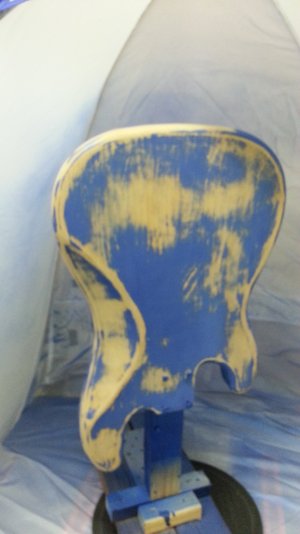

Well I sanded off the clear and a bunch of the color came off in the process. Will be interesting to see if the paint can cover this, or if it's all going to show through.
Well that was a spectacular failure. And something hit the paint job (inside the small paint booth, and there's nothing there) and completely ruined the spray job, not that it was looking all that good anyway. Apparently this doesn't cover anything.
