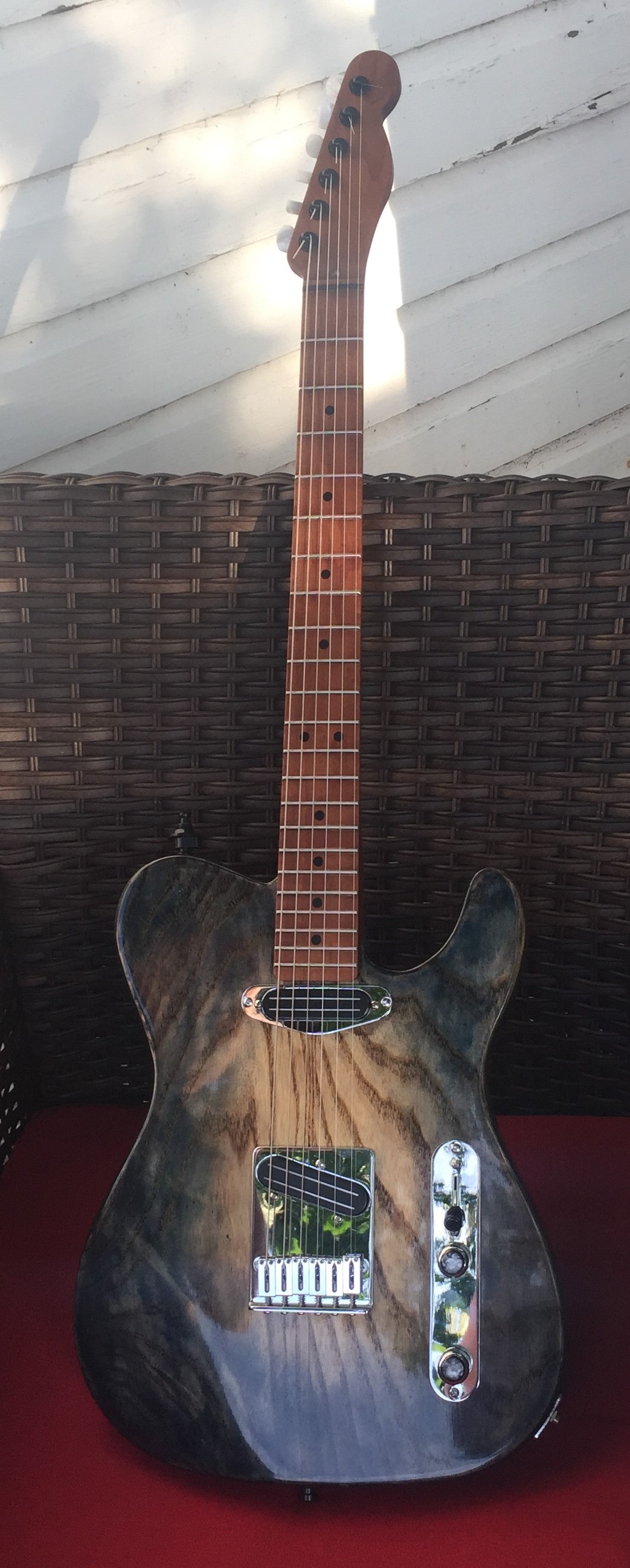

I checked mine more closely last night, and the body is a bit darker. Not a huge thing, but definitely noticeable, and more so than my pic leads one to believe. Hard to duplicate what you see in person in a photo with my phone.
So I pulled the trigger and ordered a chambered Tele in Swamp Ash with Roasted Swamp Ash top and a Roasted Maple neck with SS frets. Found the neck in the showcase and the grain pattern really looks nice.

I think you'll be happy.  I went with the swamp ash body and roasted maple neck for the Tele I built last year.  I am VERY happy with this setup, both tonally and visually.
Congratulations, good choices on both. Swamp ash, roasted or not, with roasted maple is a great combination. I have one of each. They're both spectacular looking and sounding.
