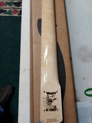

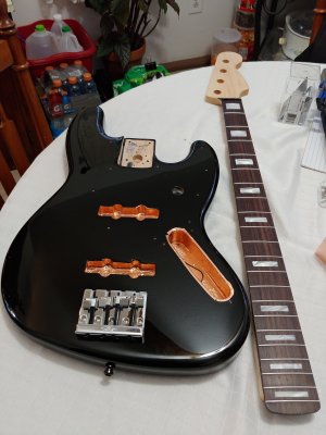

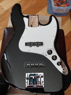

Rescued a Geddy Lee body and instantly thought it deserves a Warmoth neck! Found a nice rosewood topped PBass neck with inlays in the showcase.
Neck Specs: 1-11/16" nut, Black Corian, 10" radius, SS6150 frets, Slim profile. Body Specs: Stock Fender Geddy Jazz (Alder) body, single coil pickups, bridge and VVT controls. The overall quality of the body and parts are very good. Weighs in at ~7 lbs with hardware. I probably will change the controls to Volume, Tone and Blend at a later time.

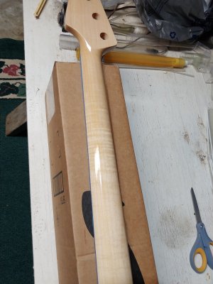

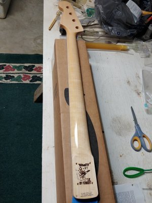

I just put the second coat of satin wipe-on poly on the neck last night and noticed a nice feature. A subtle but welcome flame bonus! :hello2:
The build should go quickly if the matriarch allows. I ran POE security cameras the last few weekends so I should be good, right?.  :icon_thumright:

Gotta love those bonus flames.  I had one like that.  It's on the white P in my signature.

I got to work on it a little bit this weekend. Applied another coat of poly and then focused on a few frets that had some sharp spots. They need a little more attention to get them the way I like them.

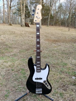

Had great weather Sunday and got to finish the Jazz. Nice and sleek. Letting the neck acclimate a few days before a final setup.

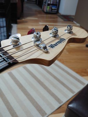

I have been experimenting with D'Addario EXL220BT 40-95 balanced tension strings. My 19' Ric likes them along with the 4 string side of my Warmoth double neck. I have another Warmoth P bass neck that hates them. I have also have a 85' Ric hates them too, it prefers EXL170 45-100.
~35 pounds difference total tension between the sets per D'Addario. Physics and wood  :dontknow:
There are so many things, many of them tiny to the point of what appears to be insignificance, that affect an instrument's character it's tough to say where one gets it's "mojo" to the exclusion of many other seemingly identical instruments. Frustrating, really, trying to create that "perfect storm".

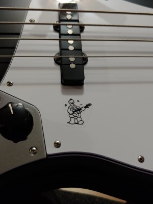

I put the heavier strings on. It made much happier! It needed some branding. Are these to spec?  :glasses9:
