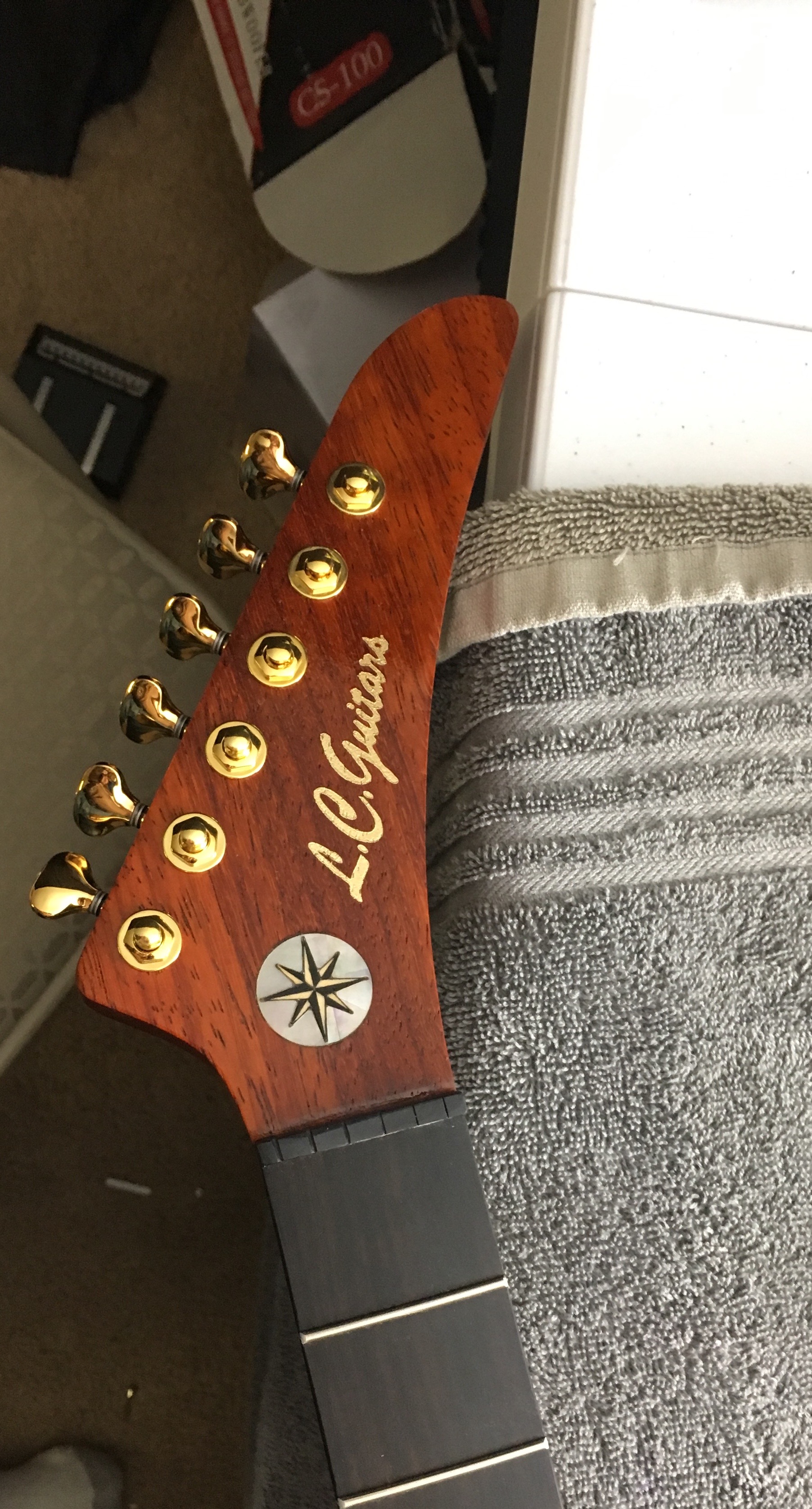

The neck...
22 fret Padauk with ebony fret board, tilt back explorer type headstock with a heal adjust truss road, this is a vintage Warmoth neck, absolutely straight and solid.
Plans for the neck, I have ordered some gold Gotoh 18:1 locking tuners, it has a graphtech nut that was set up previously. Tonight I did my first inlay!
Compass rose, mother of pearl, ebony and holly. Made by Lee Henson of
https://www.elhensoninlayanddesign.com/
I had him make the inlay at exactly 1" diameter so that I can just use a forsner bit to recess it.

While I am patiently waiting for my body back from Tonar(AKA pulling my hair out) I decided to work on my logo on the headstock. I first tried a gold decal, made it way to big and ended up taking it off. Next I made a stencil and try my hand at some gold leaf. I think I love it! going to let it dry over night and hit it wish some shellac and then top it with some gloss lacquer after a few days. I plan on leaving the grain open.

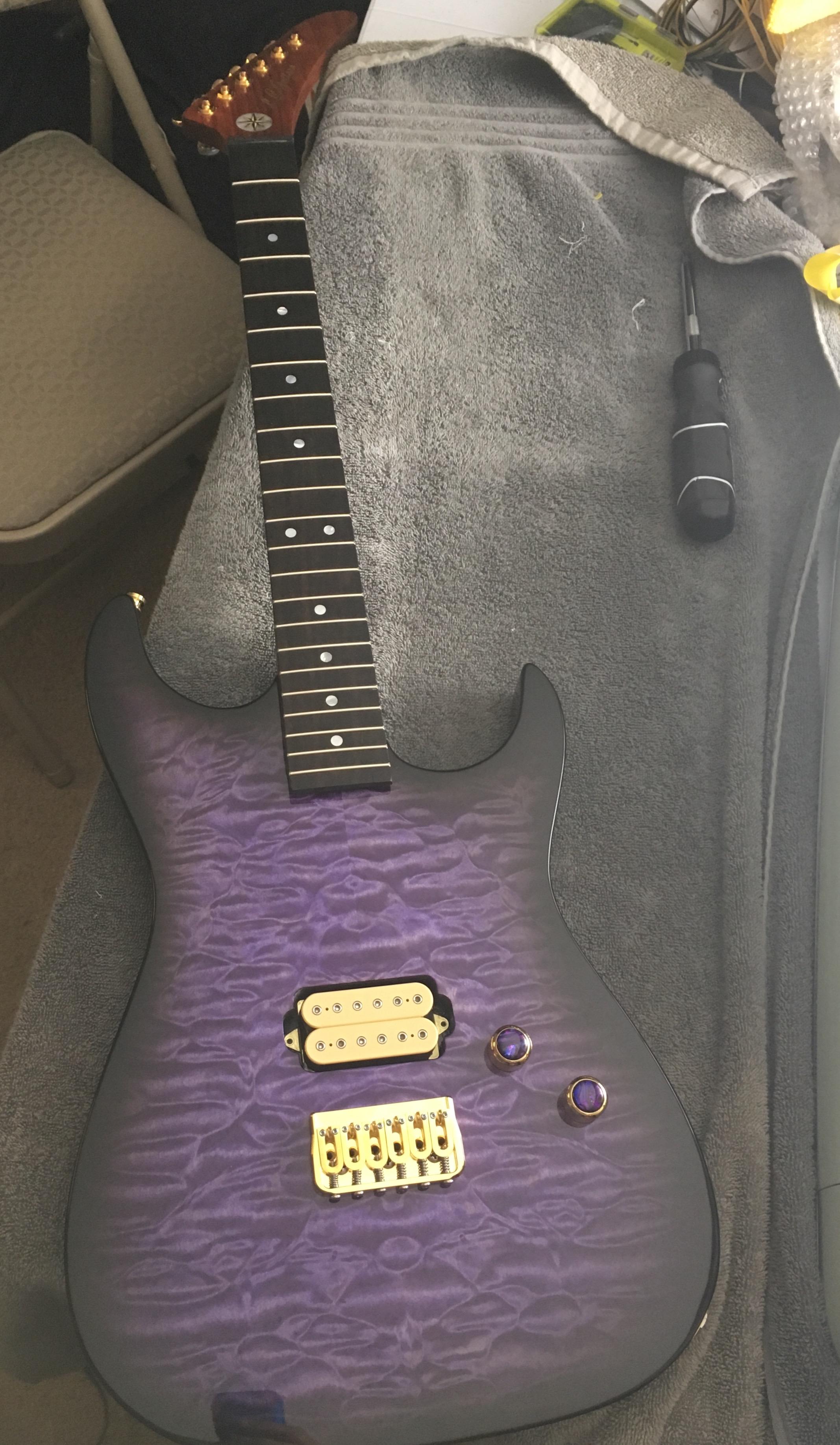

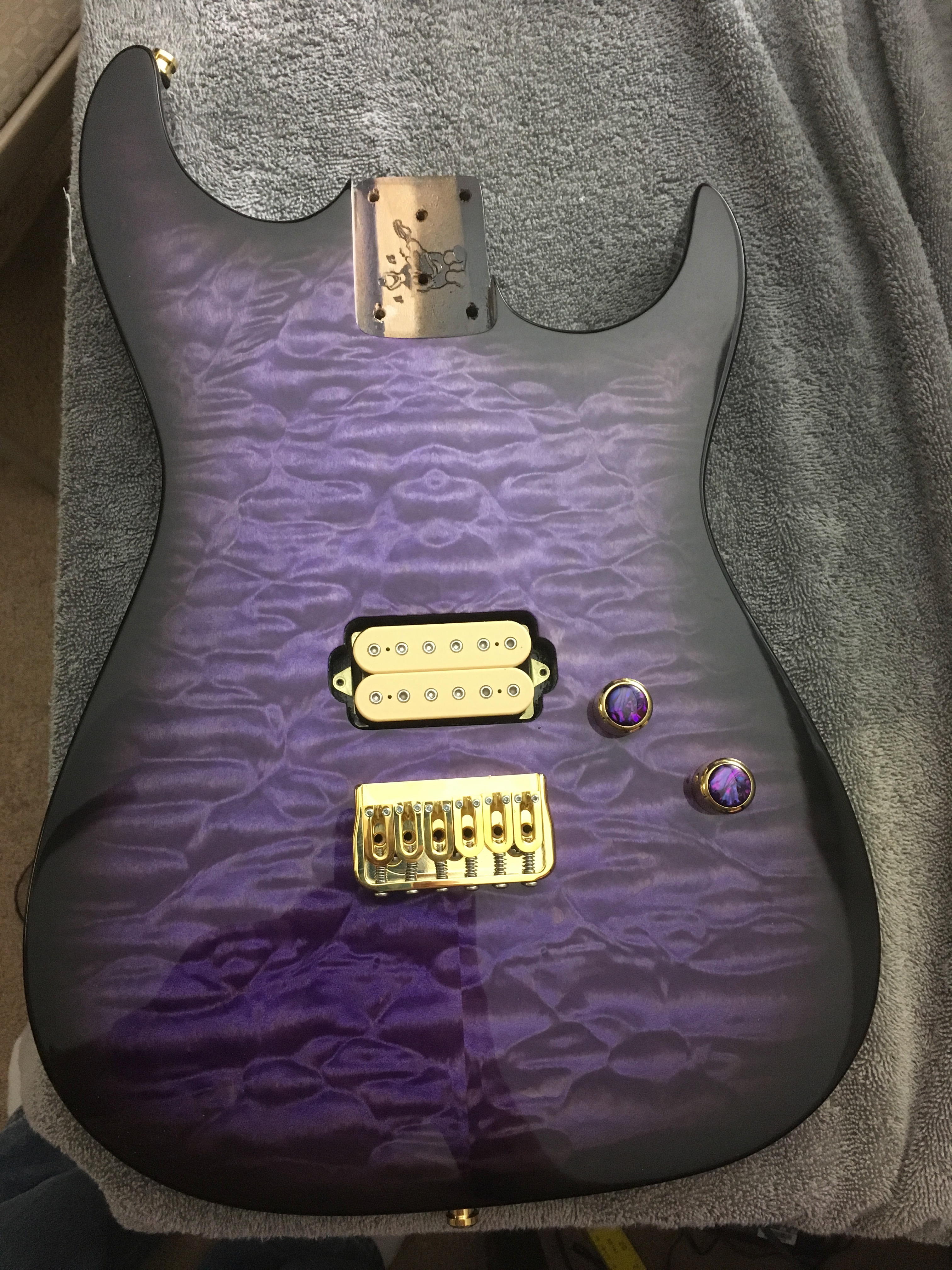

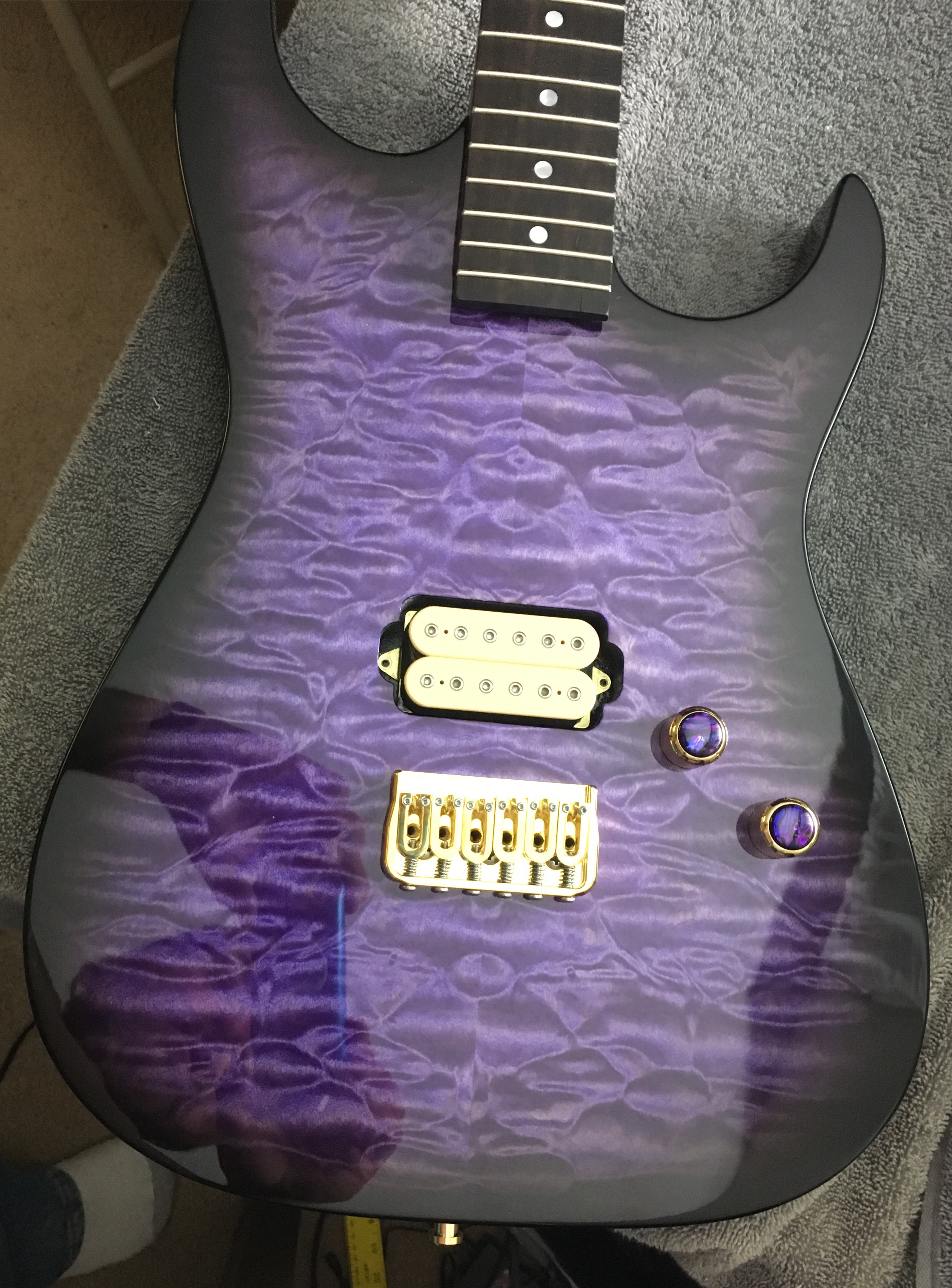

A big update! I got my body back from Tonar, all I can say is he did an amazing job, I couldn't be happier with it!
I got a bit impatient and didn't take any right out of the box photos and just started to work.
Hipshot bridge fit nice, I had to open up the two E string holes slightly to line up.
Dimarzio Fred pick-up in cream. Not sure if it will get wood mounted on a cream ring.Look at that shine!
Q-parts gold knobs with purple abalone. Padauk neck burnished to 2000 grit, ebony fingerboard.
Gold Gotoh locking 18:1 tuners, mother of pearl, ebony and holly compass rose inlay, gold leaf logo and about 6 coats of gloss nitrocellulose lacquer
I will try to take more pictures as I put Purple Phaze together
