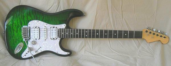

Obviously my DM strat is not trans green, but over the months trans green with black burst has become
a favrorite of mine. I liked Erik Z's strat a lot when I first saw it...

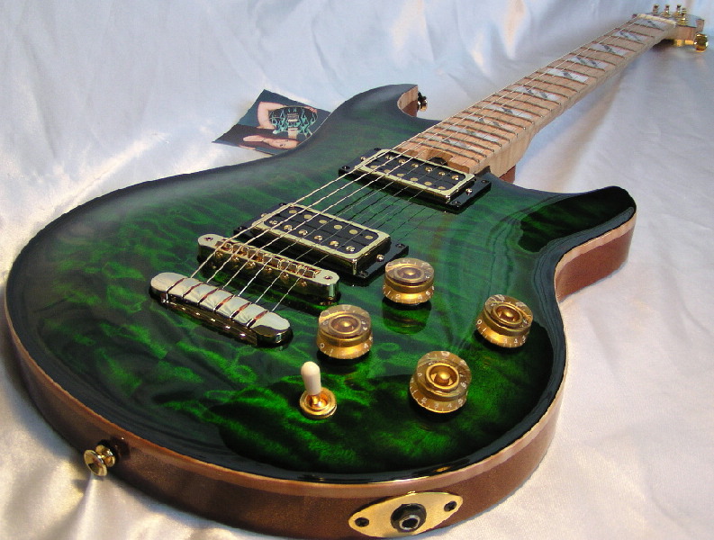

First, I want to have a trans finish. Second, I'll leave unpainted al mahogany (redish tone)....so the top has to be a calid color to match the rest of the body. To have it green....I'll have to paint the back & sides.
Something like this or a little lighter:
felipeak said:
I think Vintage amber is winning!!!!!!!!
I'm voting for that! :glasses9:
