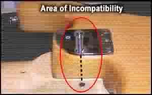

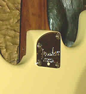

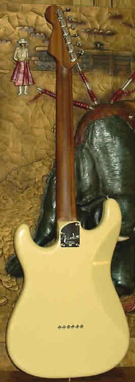

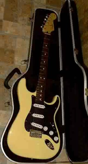

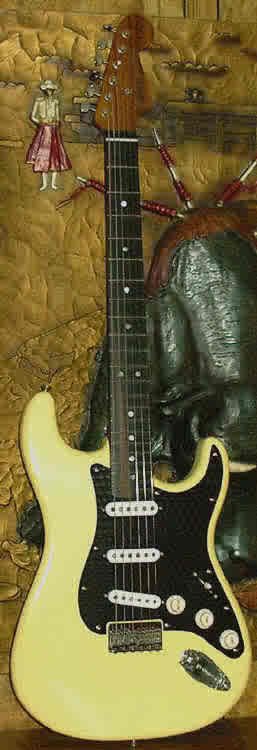

Finally completed Contour Heel build with a 4 lb. 5oz. Warmoth Ash Strat Hardtail Body routed SSS. The hardtail 4-Bolt body was converted to a Fender Style Contour Heel, a ProAttach.com II Kit was used to attach the Pro-Construction/Modern Side Adjust Neck to the body. Photos are from my outdated camera.
The neck is a beautiful Warmoth Quartersawn Goncalo Pro Neck SRV, SS 6105 frets, 1 11/16" nut width. The Ebony board edges and frets were radius block rolled together tapering off to the 14th fret to preserve remaining board width, fret ends dressed and polished. Neck mounting inserts were also installed.
Tuners are Wilkinson double row vintage top loaders, single Fender string tree, Fender spaghetti decal, Tusq nut, Fender contour heel neck plate, Fender strap buttons bored for larger #8 screws, Fender string ferrules, Fender USA '62 hardtail bridge, Fender Engine Turned Aluminum Pickguard, Guenther Jack Plate, CTS Pots, cloth covered wiring, Van Zandt Blues Pickups neck and middle, Van Zandt Rock Model in bridge position, 5 way switch and GHS Rene Martinez .009 1/2 - .043 strings.
The body was painted with nitro vintage white/yellow, no clear coats which gives a pleasing semi gloss finish and blends well with the no finish neck. Photo quality is not the best, especially front view.

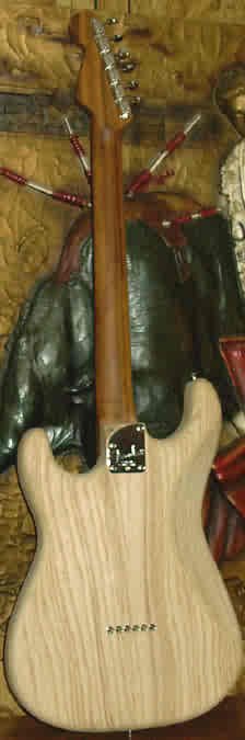

Below is the build lost in the Bastrop Texas fire...Had a nice Kingwood board, Standard thin vintage-modern 4-bolt neck, Engine Turned Pick-guard, Van Zandts, etc. As I recall the body was a Hefner, May it RIP.
