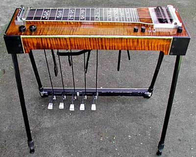

Right. Some of them get even fancier, where they have legs and a series of foot pedals with mechanical linkages to the bridge so you can sharp/flat certain strings or groups of strings. Those are usually called "pedal steels" rather than "lap steels".
Some are fancier than others...
