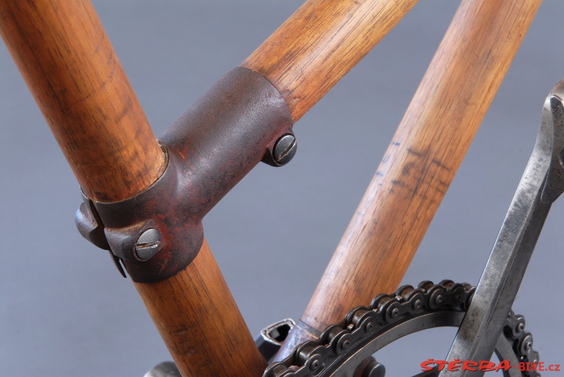

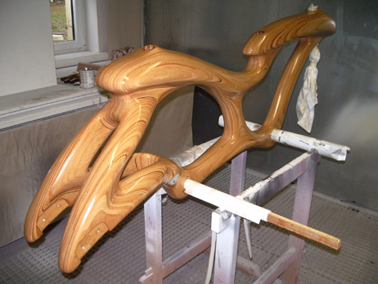

If this interests you, there's a ton of different types of wooden bike [frames] out there - from bent wood, to functional replacements of traditional  bike frames to recumbents to funky carved artwork things.  Just google for images on wooden bike frames.
We're more going for function here - getting a little tyke onto a bike without waiting on the magical combination of ergonomics, growing boys, and mass market pricing.  But that one carved bike reminds me of an one of the carved stock Anschutz sorta rifles. I must admit the hoe handle bike shot has a perverse utilitarian appeal.
That would be awesome if it weren't for the fact that I'm doing it for a little boy who's growing like a weed, and I'm DIY'ing to avoid a couple hundred bucks... which wouldn't touch the bazillions of hours of artisan labor he does. I'm afraid this one is going to be 1/2" ply slab sides, with glued & screwed hardwood clamp blocks firmly gripping  the pieces of tube we cut out of the donor bike.
