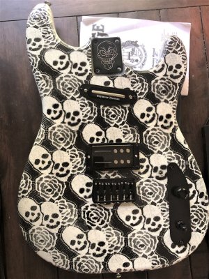

I have a new switch and full size black Tele control plate on the way . Going to mod cavity to accept vol tone and switch. I tried a stacked dual pot and knob but it was too wonky. Made the guitar seem weirdly excited.
Well, I didn't like that either, next plan up!

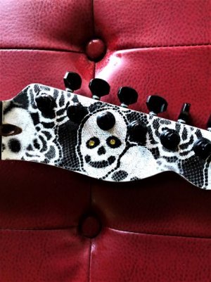

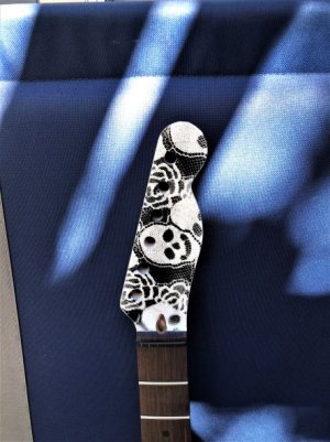

Neck arrived.

New humbucker on the way too.  :icon_thumright:

On the actual guit , I am going to set them in so they are not just sitting on top. To match the Duncan hot stack in neck, I am reaching back to hallowed antiquity with a bridge double black Dimarzio Super Distortion. :laughing7:

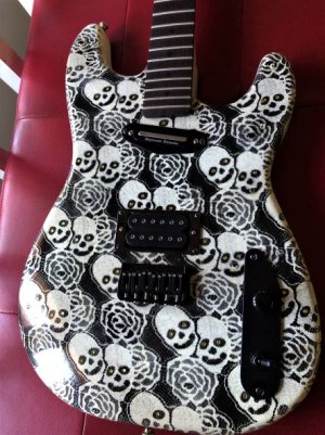

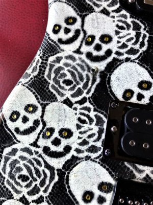

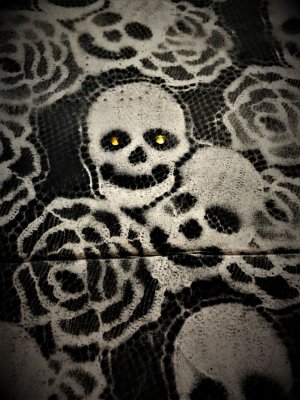

Whew, front eyeballs installed. As the back is reversed, will be setting in black eyeballs, but that is maybe for another day as I am tired an libel to get sloppy  :laughing7:  Please look away if you are easily frightened!
TBurst Std said:
I don’t to know (but feel to share) how long that took to do.  Tediously long I presume.
I believe it was around 4.5 hours, not too bad. It is slow and steady the diamonds er, I mean crystal rhinestones :laughing7: are 3mm i used a 3mm drill bit slowly by hand, (no drill) turning it back and forth to create the initial placement indent/hole then used a 3.5mm bit to just open up the top a tad so they would sit correctly flat. Then I used a needle applicator to put a drop of adhesive into each divot and placed the stone in with tweezers.
I had my reading glasses on high and a bright task lamp.
The back is gonna take longer as there are even more eyeballs. The only disruption in the pattern is the string ferrules.
That's pretty dang nifty.  If you ever feel possessed by the urge to do this again, maybe you could use a countersink bit to make the depressions for the rhinestones to sit in?

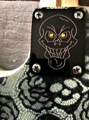

Ya don't own one the proper size, so I improvised. Not sure how soon I wanna do that again really! :laughing7: I decided to scrap plans for the back and leave it as is. However, I did use a punch and a drill with bit to modify the neckplate (forgive me Doug) to accept eyeballs. I feel that will be enough of them!
index.php
Maybe I will make a cool design on my jean pockets some day! :laughing7:
