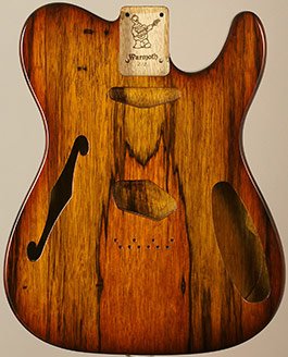

Thanks for the input guys.  Yeah the Lollar site does not have a whole lot of very specific info on the specs of his P-90's, but what I have gleaned from searching other guitar forums (gasp!) is that they are very similar in output to the standard Fralin P-90 wind, and the Gibsons that are being produced right now.  Seems the general consensus is that they are pretty moderate in output.  I guess Jack is probably right that if I am stuck on trying a Rio Grande Bucker ( and I seem to be) then maybe the Genuine Texas Bucker will be the better match.  Any one have one?  My other frontrunner for a bridge humbucker is a Gibson Burstbucker 2, but I have just heard so many great things about the Rios, I want to give them a try.  Oh, and by the way, I could wait no longer and went on the E-store and ordered a body and neck off the showcase.  I just don't have the patience right now to do a finish, so I picked the lightly bursted black korina thinline in this picture.
they are going to route out the proper pickup config. and it will go with this neck...

Oh, I was lusting after that same body! Beautiful. I just ordered a Lollar P90 too, and Mr. Lollar told me the stock neck wind is 8.2k. Hope that helps. I'm swapping the Rio Grande Jazzbar for the Lollar on my walnut thinline. If anybody wants to buy it, pm me (Rio Grande jazzbar, black soapbar cover, all 11" of lead).
