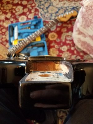

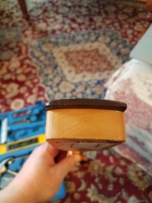

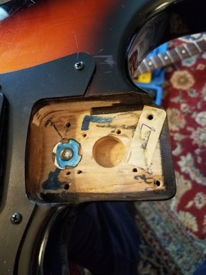

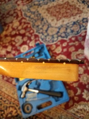

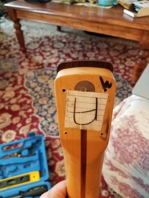

@Bruce Campbell can you post some pics of the original neck at the heel end both front and rear and the neck pocket of the body etc. I am wondering now if your original body and neck are to a different spec than something complying to vintage spec.
How many frets does the original neck have, and does it have a fretboard overhang?
Thanks for staying with this, stratamania. I'll post some pics tomorrow when I take the neck off. I'll also measure the pocket for the relevant dimensions - it does seem like something could be different from vintage spec on my American Standard.
The original has 22 frets, and a slight overhang.
Upon measuring the neck pocket, the length is 2 15/16", width is 2 3/32", depth is 19/32". So maybe that 1/16" is enough to throw off the intonation?
I’m on my phone, so looking at a small pic, but the guard seems to be extending over the neck pocket.
could be tolerances. We have have a number of people here over the years that thought the neck completely set, but it didn’t. Easy check, remove the guard screws and shift it back, then reset the neck and check intonation.
