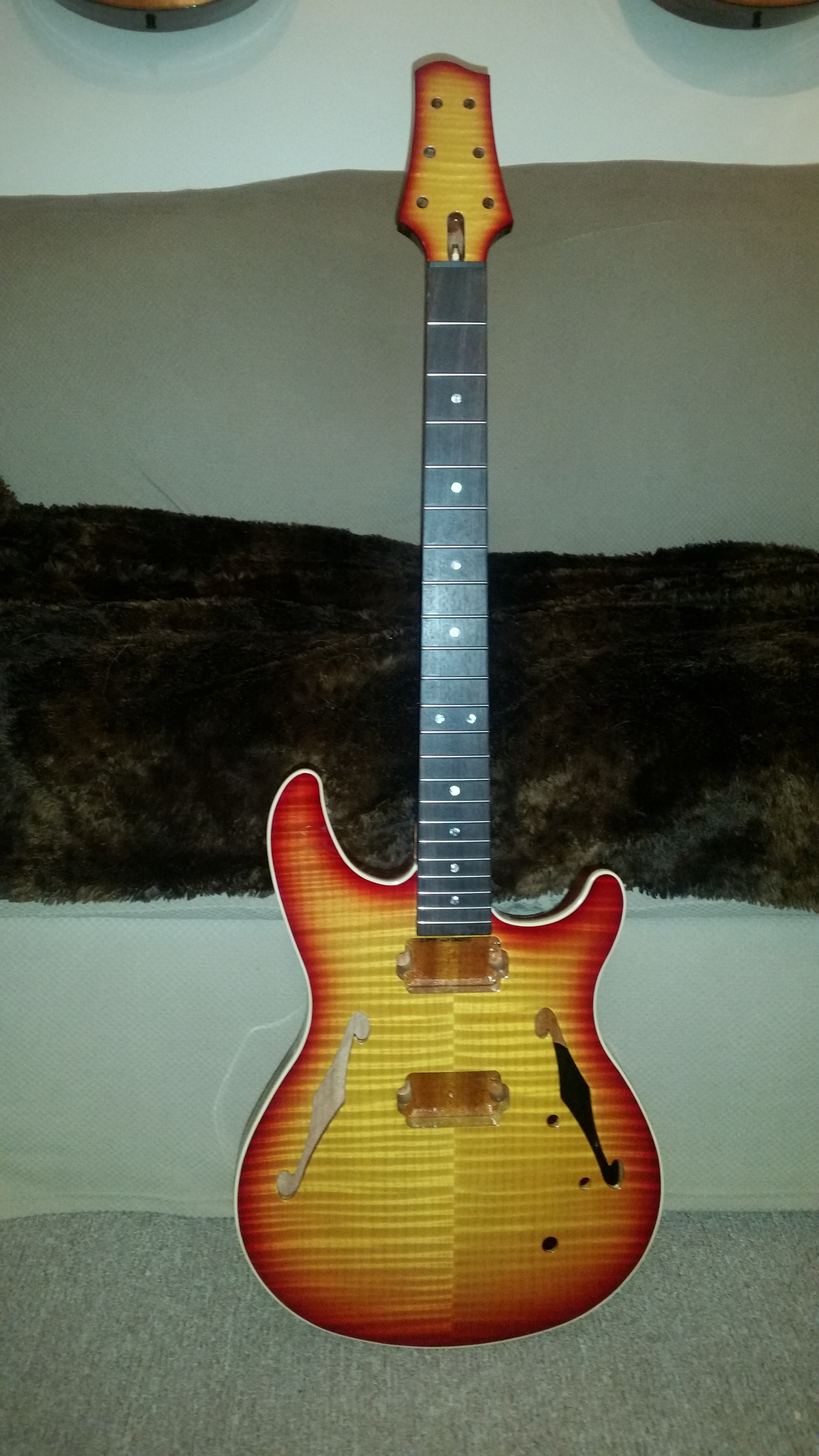

New VIP just delivered... now the fun begins
kolsky
42
the plan is to have a mag/piezo combo rig with stereo outputs for a dedicated piezo amp:
mag pickups are SD alnico II pro's (splitting coils), piezo is the graphtech ghost loaded wraparound bridge with their acoustiphonic pre-amp, gotoh 510 18:1 tuners.
Another 2-3 weeks for the build!

bridge holes and more!  have to accommodate the piezo switch and volume knob as well
BroccoliRob said:
The striping on that mahogany body is dank as hell, brobro. Great score
thanks, man...  it's one piece of mahogany, too.  this is my second warmoth build and i am very impressed with the quality... far exceeds expectations.
You're already off to a good start. The matching headstock looks great. Looking forward to following this one.
I think that's one of my dream Warmoth bodies, what you just got. There had been a body almost identical without the f-holes in the showcase a few months ago, same finish. If I had a job I don't think I could have resisted pulling the trigger...

thanks!! i had mine custom built and painted to my specs... including picking out the chevron flamed top!  have to say i was a bit nervous waiting 8 weeks for the delivery to show up but blown away once i saw it.  another 2 weeks or so and i'll have a piezo/humbucker rig.  have to pick out an acoustic amp next to power the piezo bridge.  looking at a used fishman loudbox!

Fantastic piece of equipment you're building here.  Just fantastic.  The matching headstock is amazing.  Do me a favor, show me a pic of the matching backs.  It looks like you test fit the neck, just turn it around for me.  They look like they could be cut from the same piece of wood.  Is the neck meat mahogany, too?
In the fitted picture you can really see the differences between the f-hole that's over wood and the one that's over the back control cover.  As the soon-to-be recipient of a body with f-holes, are you planning to darken the inside of the wood?  I've not done one before.  Purely a question of aesthetics?
the mahogany on the body is amazing!!  it's a bit lighter in color than the neck.  I don't plan on painting the inside.... kinda like the unfinished, traditional look.  It's with my guitar tech at the moment but will be done in about 10 days.  more pix coming!

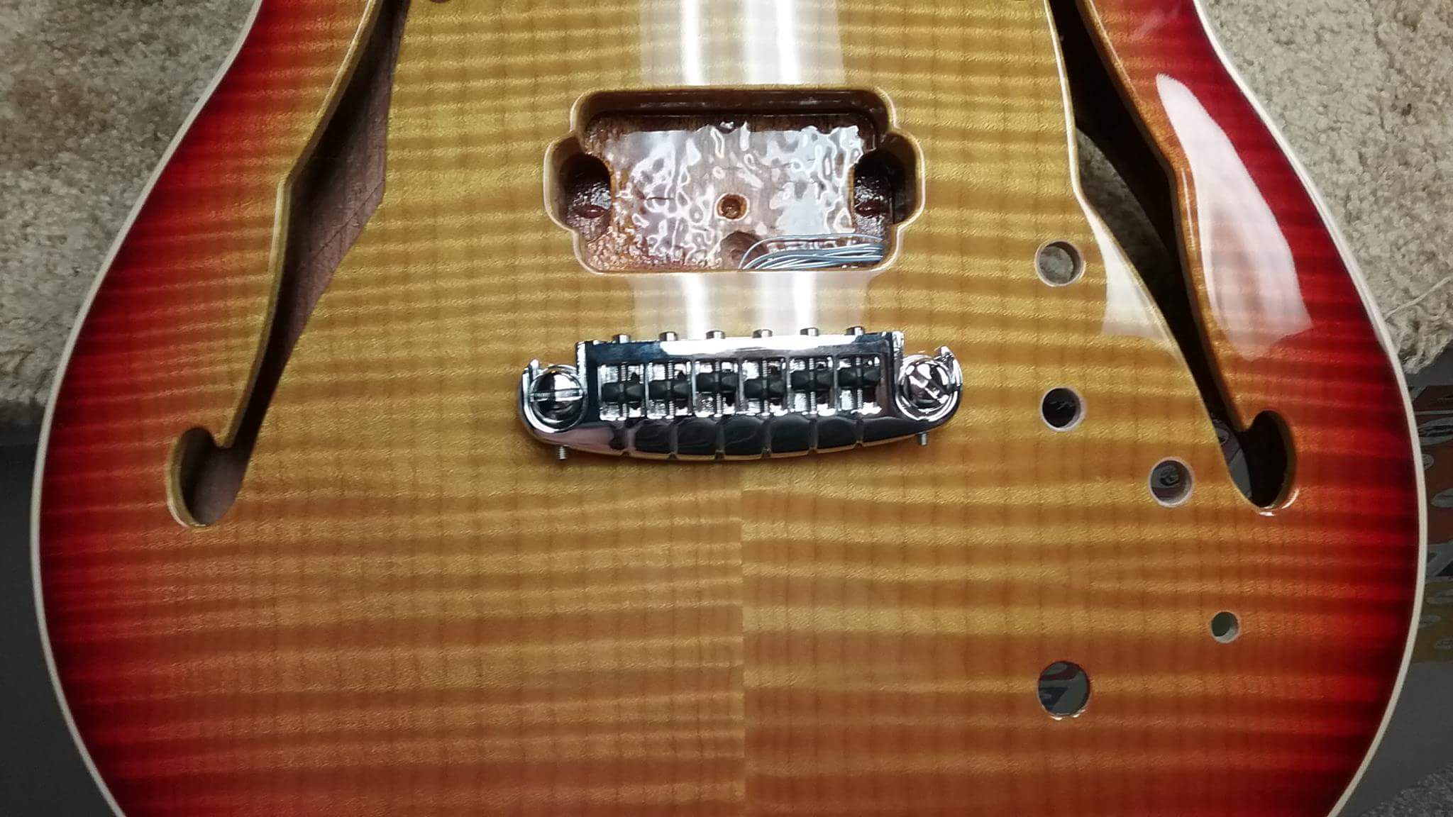

Graphtech Piezo bridge with wires installed and hole drilled for vol/toggle...  Have to order a battery box and install it since there is no room in the hollow cavity for it.
Hendrix said:
can the battery box made it on back control cavity plate ?
no room... i will route a new place in the top cavity or the solid block portion. there is an electronic on board preamp as part of the piezo bridge system.
